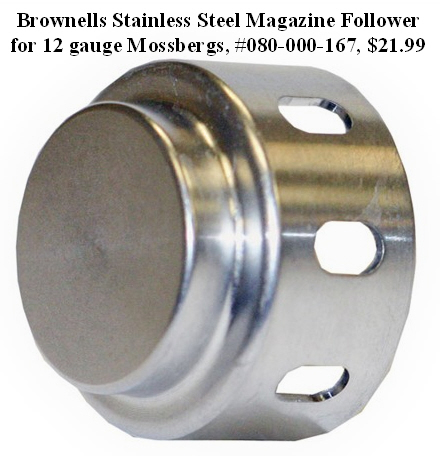

If you can sell your 500 for $250, you can apply that towards a new 590. Otherwise, take a look at the Brownells MOSSBERG 500 HIGH CAPACITY (8+1, but probably 7+1) SHOTGUN KIT, 078-000-162, $150.99. You may also want to get a Brownells Stainless Steel Magazine Follower for 12 gauge Mossbergs, #080-000-167, $21.99 and a Wolff #17905 Mossberg 590 9 Shot XP Magazine Spring, $8.99. Welcome to the Basement, and good luck, sonrider657.
MAX100 wrote:
The mag spring needs to extend past the mag tube about 8". I would go with the Wolff universal 12Ga springs. They are very high quality and strong with thin wire coils that are wide set and allow the most room in the mag tube. They come 40" long and need to be cut to size. Cut it to 28" or 29" and bend the ends down closer to the lower coil so they don't stick up. I buy 100 at a time. I sell them already sized and shaped for the 590 shotguns. GC
