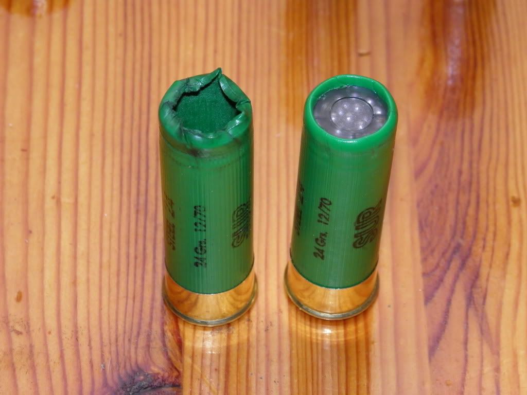

I've just got my hands on a BN2 and a BN3, I've used the BN2 with the disc closure with good results for my steel loads
Thanks Bjarne
 Post subject: Re: Gaep Roll Crimper T1 to T4 ?
PostPosted: Wed Dec 29, 2010 7:12 pm
Joined: Fri Mar 19, 2010 2:18 pm
Posts: 162
Location: Denmark - Randers
Forgot to give you some pictures of the results, the BN2 gives nice results with used shells
Thanks Bjarne

For hunting I reload to get them both faster and heavier, the shown load is with 34 gram steel and gives v2 with 470 m/s – 1542 f/s for the cost of only $0.70, would probably be cheaper to load in US as the components are much cheaper
Thanks Bjarne

I use the C&P T2 (Cortini & Pezzotti) for roll crimping slug loads, that produce a crimp equal or better than factory roll crimped shells.
I've heard the same for the Gaep roll crimping tools.
Another use of these tools is to iron out the end of a fold crimped hull, especially when using new hulls. Results are the same. Loaded shells look like factory new or better.
Lefteris
