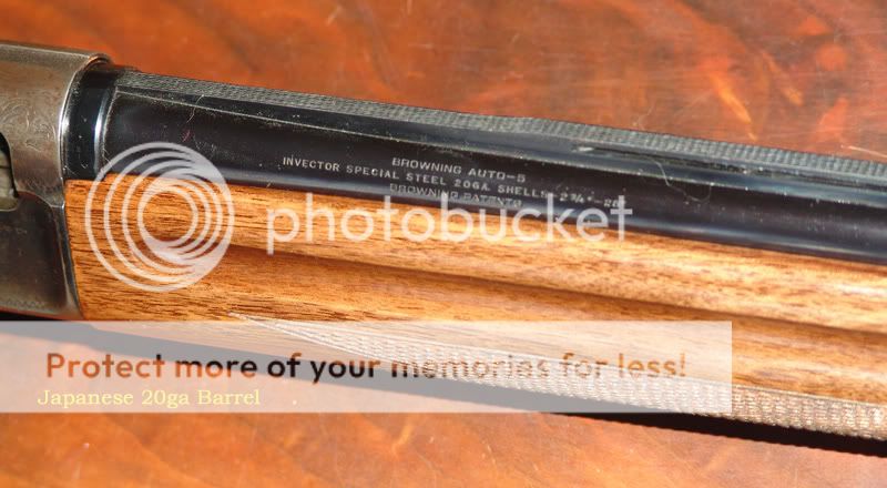

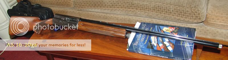

Not a cross brand conversion, Japanese Browning 2 3/4" 20ga Inv barrel into a Belgian Browning 16ga 2 3/4" Standard receiver(R99,4xx, so end of 1957). Sorry if I wasn't clear. The extractors on the bolt needed modifying to grab the smaller rim. And I tried to get a 20ga two piece lifter to work, but ended up with the 16ga lifter original working the action.
The barrel/receiver setup is quite different between the two, as you rightly point out. And impossible with the Rem without changing barrel extensions between gauges. With the price of an A5 in a Light Twenty usually approaching the grand mark, I sprung $150 for the barrel and with a $250 beater 16ga sitting in the closet with a bum barrel, it was worth a try.

Here's some pics of the "plug the 20ga into a 16ga" experiment. Works well, though the speed load is a touch finicky. The extractors had to be modified and the cartridge and magazine stops had to be adjusted to suit the thinner shell. The ring setting is light, I'll get a 20ga recoil spring, I suspect they're a little weaker. Function is not quite a 100%, I had a hangup last 50 rounds at the clays course, a little more polishing on the internals I suspect.
It was an interesting exercise, and no regrets about doing it, I learned a lot about the internals of the Auto 5. Still managed to crack 40 but, {:o).
When economics permit I will get a Light 20, but as mentioned above, I had the rather tired 16ga standard and stumbled across the barrel at the right price. I did find a 20ga forearm, so that's the right fit on the barrel.
