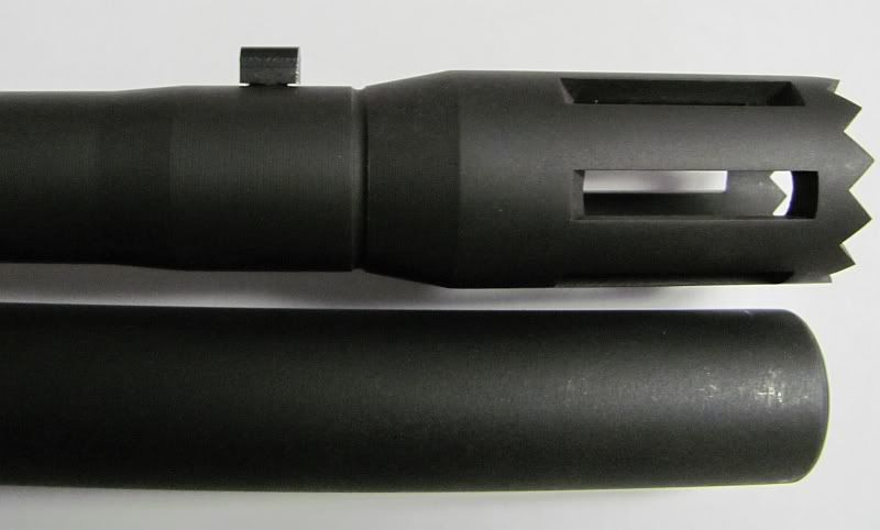

Hi guys... I was wondering how the front sight is installed on my 930 with breacher? Looking down the muzzle I can see that the breacher is covering the spot where the sight post could be seen if the sight is screwed in, it could be screwed in, I'm just not sure if that is the case.
And... What can I replace this sight with, "if" it is a screwed in sight?
Here are 2 photo just in case if needed... Yes, my front sight is canted a bit, I'm not to worried about it, it shoots where I am aiming, but I haven't shot anything past 30 yards (the 930 is a in the house protection gun, also reason for the breacher end, striking if needed).

It's screwed in and loctited....
Put a piece of electrical tape over it so you don't scratch the finish and unscrew....
Righty tighty, lefty loosy

Thanks Smitty... Have any other info, like what size thread pitch this post is and what would be a good replacement sight for my application (home defense)?

Sorry for the delay........
Check Midway or Brownells, they have several options...
The thread size is 5-40...
A lot of folks like the Tru Dot night sights: http://www.brownells.com/.aspx/sid=7586 ... ght_Sight#
Good Luck and let us know how you make out....
