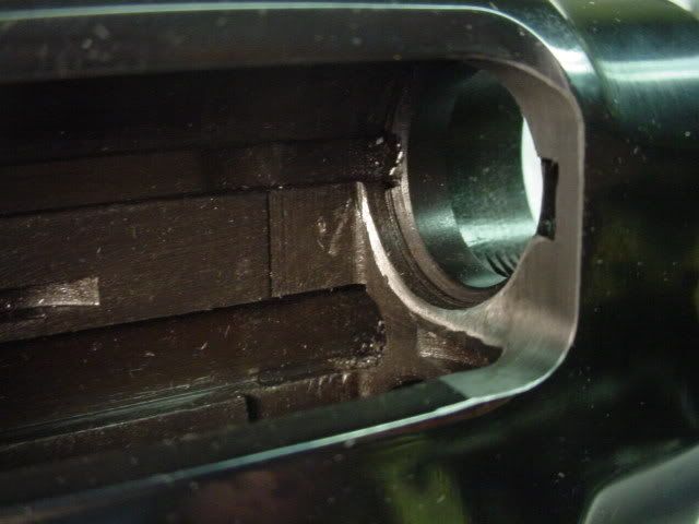

Here is what I showed in a previous posting:
On occasion I have had to open the ejection port slightly when the clearance was insufficient to allow free shell ejection motion.
You will lose the blue in that location until or unless you get a reblue, (try a black marker to dull the shine) but the gun can be made to reliably function with the full range of standard length shells.
This is one 16 ga. that I am converting.
Proper clearance and verification of operation will make your Winchester Model-12 shotgun all that it was meant to be.
kirbythegunsmith@hotmail.com
Model-12 specialist gunsmith
I realize that the port contour does not match what the factory did to extend the port for the normal 2-3/4" small ga. and create the Magnum 12 ga., and that is part and parcel of making one of these examples have the ability to digest virtually any shell within the modern SAAMI spec. Those contours were created during the paper hull heyday and plastic hulls weren't even a consideration.
I know of only one Magnum where a guy had some remainder shells that were loaded in European hulls that created an occasional issue that he has yet to have me investigate thoroughly, since those shells are never going to be bought again. Those actually measured a bit over 3" fired length.
He has sent me a number of Model-12's to rework, rebuild, and optimize for his hunting pleasure. I'm assembling a 16 ga. for him right now and installing some like-new wood that I got just by chance.
The port contour of the standard 2-3/4" 12 ga. and older short chamber 16/20 is the small radius lower corner that- when coupled with a longer profile- allows sufficient clearance and even a bit of surplus for crimp wrinkled edges from heat-sealed case mouth flashings.
That is inclusive of the total rework package that I do to optimize the mechanism for assembling, loading, feeding, stroking, ejecting, cocking, locking, bolt lockup, bolt retention, extraction, slide lock release tension, magazine band and tube alignment/sliding insertion/positive locating/rotating/retention plus ...
I provide (for those wanting an extra-special Model-12) a comprehensive rework of just about every surface and edge that induces any possible level of drag or wear beyond what precision machined parts should have, and the mechanisms have the best chance to improve and get even smoother with time. This is done without removal of significant amounts of material that would alter the inherent tolerances already present or expected.
I provide similar reworking to all manner of mechanisms- from Classic Browning Superposed/new Citori Target doubles to Mossberg pumps meant for home protection, and plenty of Semi/Pump/Bolt rifles and shotguns that include Benelli etc. waterfowl user favorites.
I fit my custom chokes in the same manner that I fit these parts to each other: close and even closer; smooth and even smoother. Alignment is another aspect that I always emphasize- whether it is the choke hole and tube or the action slide arm and slot.

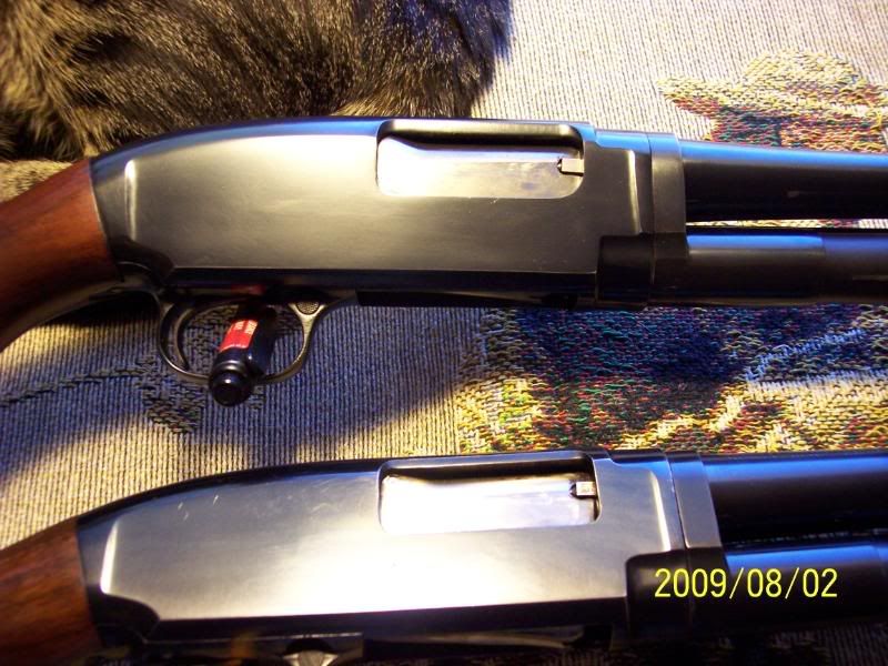

This pic shows the difference in the ejection ports, top one is the longer port for 2 3/4" shells.
A pic of another modified port probably done by a local gunsmith as it is different than ones modified by Winchester.

Walt,
the person that modified that frame must not have thought that blending of the alteration was to be of primary concern.
If that cut-out has sufficient hull clearance, I'd say that was a definitive example of "strictly utilitarian" rework.
I prefer to make the blend just a bit more unobtrusive an it can't hurt to be imitative of factory profiles i.e. making port alteration contours appear as the 2-3/4" 12 ga. style with the end corners in mirror profile.
The explanations concerning the extending of the port are not the end of the alteration or the beginning, either.
The totality of the mechanical function is something that I carefully examine to judge where and how much of certain alterations are necessary to make the package reliability a certainty.
The port alteration is something that should be included if a shooter wants to have the option to shoot whatever shells that they might want to use, rather than be limited by the shells that they need to buy- especially if not a common type found on the shelf in typical stores.
With the number of shooter grade Model-12 small ga. guns out there, I don't see as sacrilege the notion of altering one for shooter use. I might admit that it would seem better to use a less-than-pristine example as a subject to convert, but the owner does get what he needs to do the job when he asks me to make the gun run like the proverbial scalded dog.
I have had to convert enough clean-looking guns that failed to be reliable to consider looks as the detail in need of conservation- especially if the blasted thing won't shuck worth a durn.
When I recently had that grade-5 Browning Model-42 here that would fail to this and that in a quintessential example of basic NIB (practically) failure to perform, most shooters would have been absolutely appalled by the overwhelming lack of living up to the Browning or Winchester reputations concerning quality of manufacturing, design, and function.
Just another example that luckily didn't remain as a polished t...
