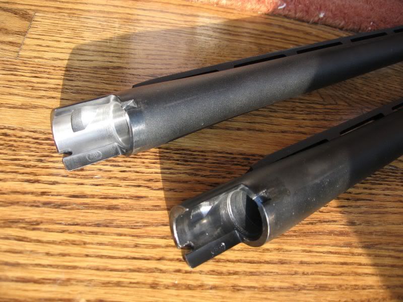

I think I may have found the issue. I was always looking "in" the chamber. Look at the surface just above the oval engraving. As that surface nears the chamber there are a lot of tool marks. Those tool marks grab the rim of the shell (after its fired, the shell's rim expands into these marks or grooves). I used a dremel to smooth out those marks (on the original barrel, Remington sent me a new barrel as they failed to fix the original one).

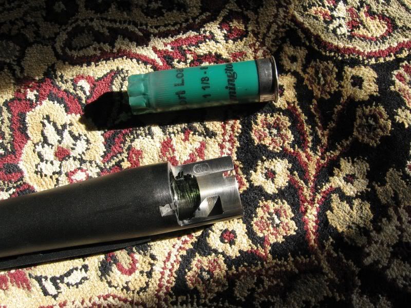

I put two fired shells in the barrel (unassembled) and the both stuck. After the dremel job, the slightest pressure will get them out.
Original barrel on top:

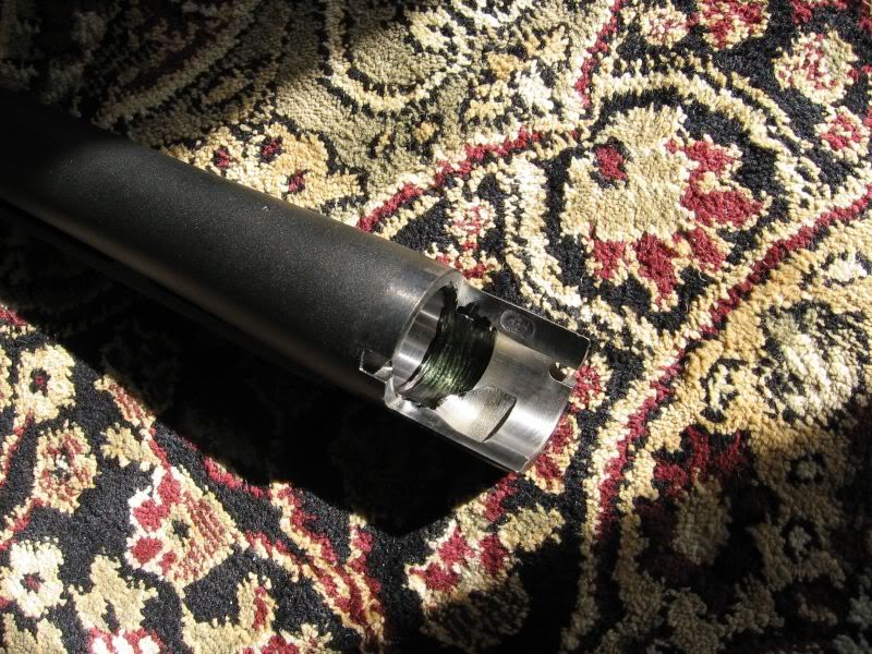

So I smoothed out the area discussed above (on original barrel) and put four shells through it. Before shooting I inked up the area so as to be able to see any tight areas (scratches) during extraction. Gun fired 100% and I'll be testing it some more. Ink showed one very small scratch.
Before shooting:
After:
The new barrel has the same tool mark (not as bad), so I smoothed those out too. I am very unimpressed with the machining work on these barrels.
EDIT: 8 more shells fired, 100%.
