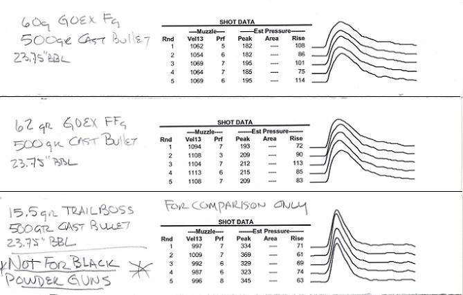

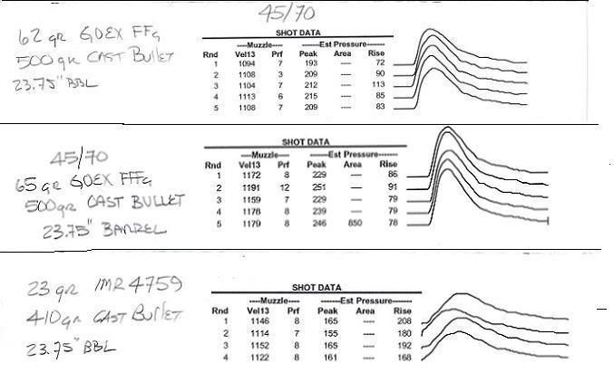

Some pressure curves newer than 1897:
They are from a 45-70 rifle. The originals used BP cartridges. They are for comparisons between BP and Smokeless only. Dont try them in Shotguns!
The 'Rnd' is just the shot number. 'Vel13' is the muzzle velocity in Ft/Sec. Don't know what 'Prf' is. 'Peak' is the peak pressure if you add two zeros to it. 'Rise' is the time, in milliseconds, the pressure takes to take to go to the peak pressure (from something like 20% of peak to 80% of peak pressure, lower times =faster rise rate).
Velocities are all in the same range which provides a good basis for comparison.
The Smokeless IRM4759 shows a lower peak pressure and slower pressure rise than the FFG and FFFG Blackpowders with equivalent velocities. Note that this test used a 410 gr bullet while the others used 500 gr bullets. If the heavier projectile were used, the pressures and rise rates woud have increased some.
The Smokeless 'Trail Boss' shows about twice peak pressure and almost twice the rise rate. It also had the lowest velocities. Not a good choice! It's for handguns.
You can find more info on these curves at: http://www.levergunscommunity.com/viewtopic.php?f=1&t=27410
