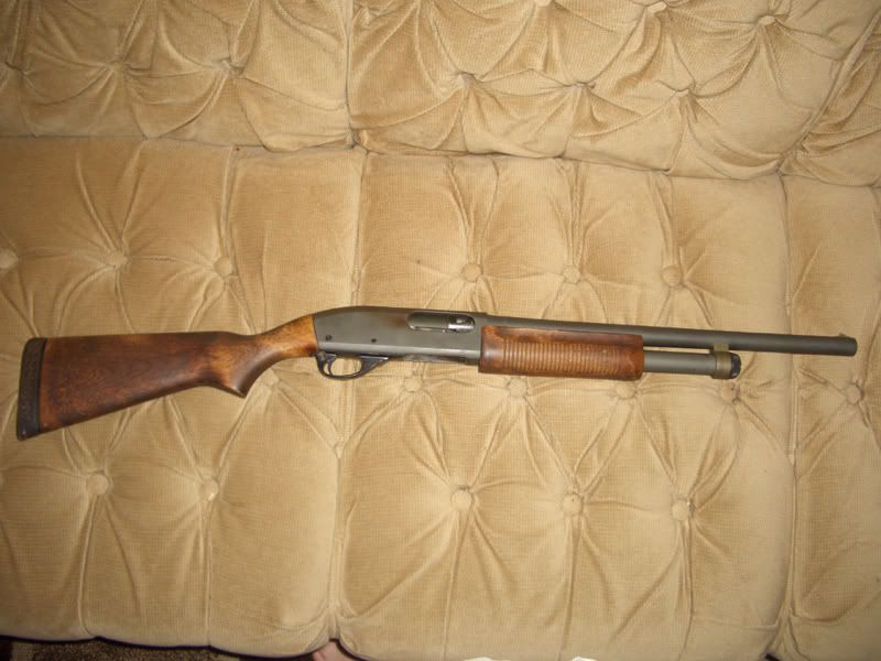

Although I haven't started cleaning/refinishing it yet, I did get some pics of the 870 before starting. The 870 is roughly late '60's/early '70's vintage and owned by the PD I work for. No one seems to want to clean the Dept issue shotguns, so I broke down and am doing it. I did it last time (about 2 years ago) and swore I wouldn't do it again, since I have to use my own stuff, on my own time. However, I came to the realization that if I don't do it, it won't get done, and with my luck, there's a good chance that I'll be the one needing the shotgun, so I broke down and am doing them. Typical bone-stock riot gun, parkerized finish, 18 1/2" barrel, bead sights, wood stocks, standard 4 rd tube mag, no frills at all. The Dept has 6 or 7 of them; Typical of most Police guns, they have been carried a lot and shot a little. The outsides look kinda ragged, the insides are still in good shape and they shoot well.

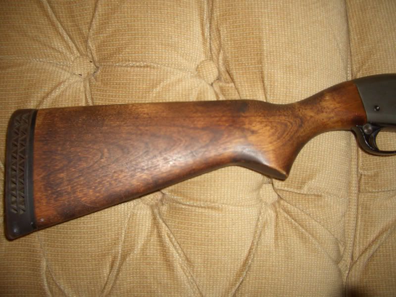

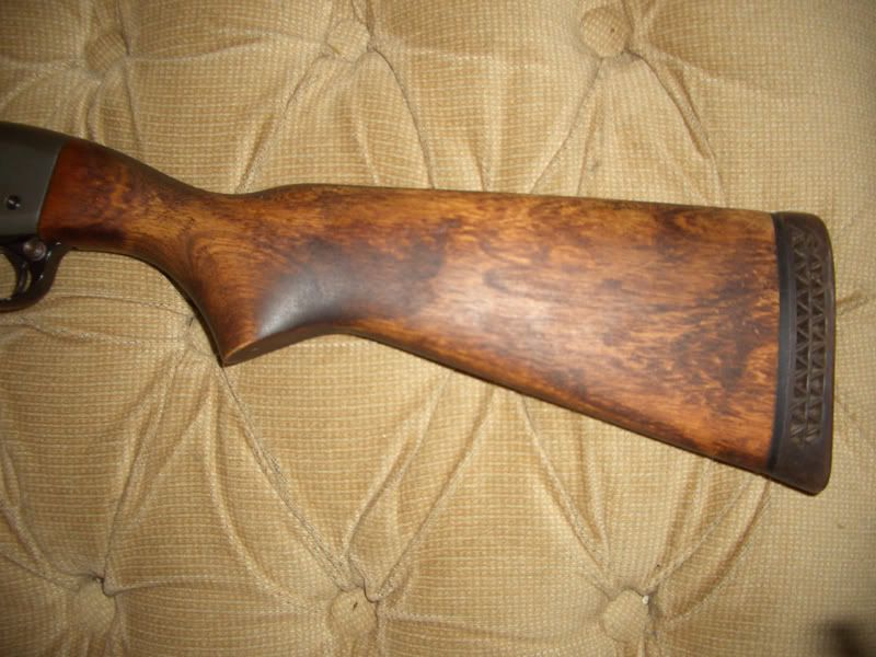

First two shots, shotgun as it sits right now. Stock dirty as heck, some corrosion and discoloration on the parkerizing, which is of course bone-dry; pretty typical Police gun.

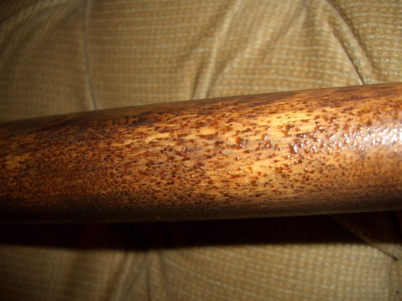

Second two shots showing the oily, grimy, sticky, disgusting filth on the stock. These guns were cleaned (by me, incidentally) two years ago and the grime wasn't there then. If someone tells you that cops are pigs in their cruisers, BELIEVE THEM! This particular shotgun was in a cruiser for the entire 2 years, only taken out occasionally to check and make sure it was loaded and "cruiser ready", hasn't been shot since last cleaning.

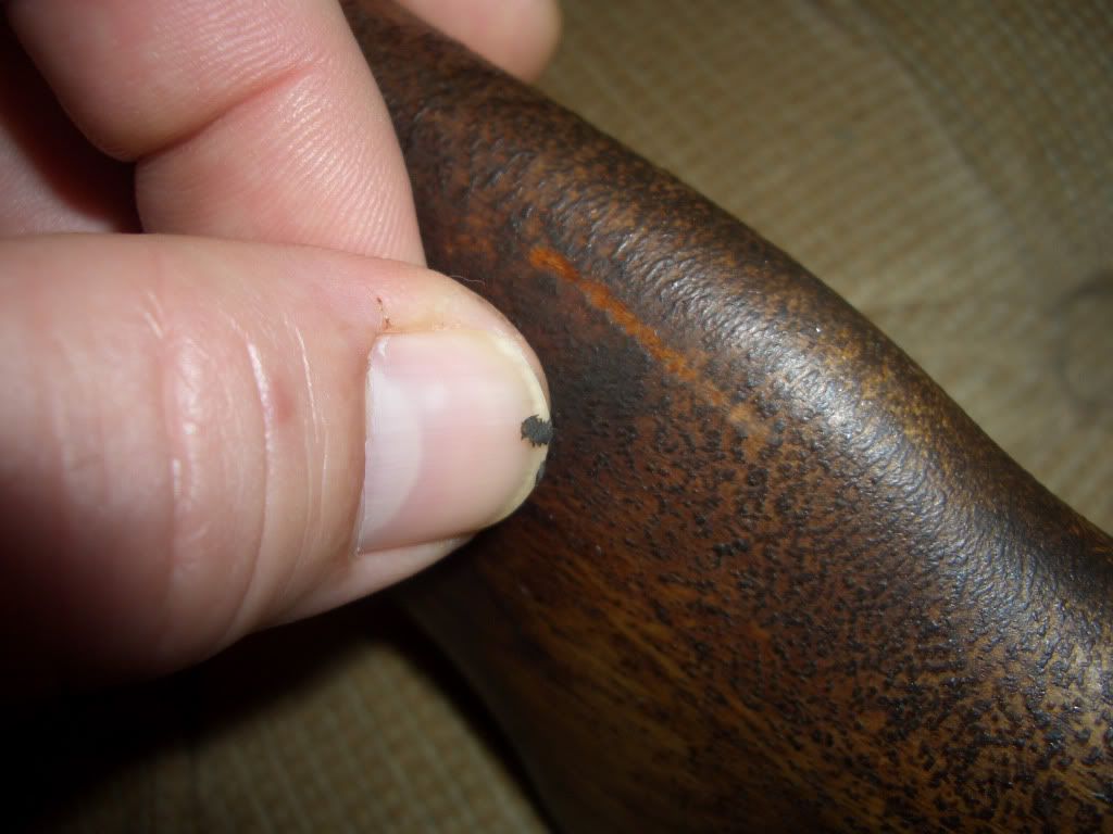

This shot shows some of the problem- the finish on the stock, probably linseed oil, has apparently started coming out of the stock in the heat of the car, beading up, then curing, attracting dirt, grime and filth in the process. I've never seen a properly cured linseed oil finish do this, but that's all I can figure it is. It's not soda or anything else. The oil should be well cured, given the age of the gun, but like I said, I can't figure out what else it might be.
Pic of the filth/grime on the comb, right behind the wrist of the stock. That's the grime that I scraped off with my thumbnail and you can plainly see where I scraped it from. EEEEWWWWWWW! DISGUSTING!
