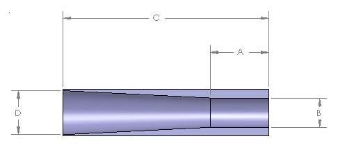

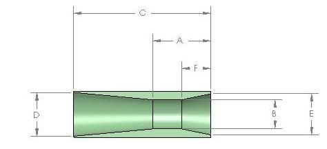

How are you measuring your chokes? If you don't have a bore gauge, you may be spinning your wheels. Some chokes have a continuous taper. What this means is they must be measured at the very end to know the final constriction. Some chokes have a parallel portion. Some chokes have weird shapes. Consider these pictures:
This is what a normal choke looks like:(the drawing is exaggerated so you can see the design)
This is what my Ljutic chokes look like:
Every manufacturer is different. So, we can't tell you a specific depth to look for.
In the end, the actual diameter of the choke doesn't matter. What matters is how large a pattern do they create at 40 yards? That is the definition of a choke, not the tube diameter.

"Rastoff"... Great information/sketches. That is why I asked. Measuring is difficult if it is a continuous taper, though I believe most chokes do end parallel. You can obtain decent measurements with a quality telescoping gage and good 1" micrometer, even at the end of a tapered style. Good info... thanks, :)
