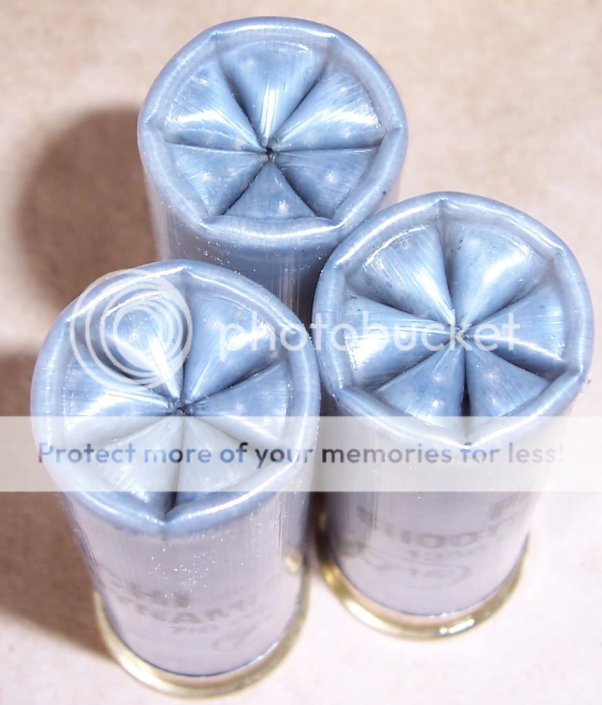

The Spitfire wad is BPI's name for the Gualandi GU-1225, - a 1 ounce wad. A year or so ago, your could get a case of 5,000 delivered to your door step for $107. BPI has since changed their pricing.
Since then, S+S out of Florida has been selling the Denmark Harpun HW-120 1-oz wad for $109 per 5000 count case to your door (free domestic shipping) making them a slightly cheaper alternative to even the Claybuster CB2100-12 (12S0 clone) from Recob (shipped to Seattle). They can be ordered at: http://wads4u.com/12-ga-Lead_c2.htm
The Harpun HW-120 from S+S, and the GU-1225 (Spitfire) from BPI are shown here:
Legend (left to right): Harpun HW-120 from S+S, Spitfire (GU-1225) from BPI
There were three different height base wads used in the Fiocchi hulls, with the most recent (and most common) one being 7mm. I believe all clear/translucent hulls are of the 7mm variety.
When using 18-20 gn's of Clays, and either the HW-120, or the Spitfire GU-1225 (or even the Claybuster CB6100-12), you will not have to make any press adjustments to your MEC when switching between the Remington's with ~17-18 gn's of Clays and the Green duster and most other 1-oz wads.
Your crimps should look like this:
The Fiocchi's are great hulls to reload, and there is no reason not to reload them.
Also, 17.5 gn's is too light for this load in my opinion, - run that up to at least 19 gn's. I load 20.0 gn's of Clays, but I also load them for a Benelli Cordoba, and so I wanted a hotter load to cycle the Inertia-driven action with heavy clothing.
