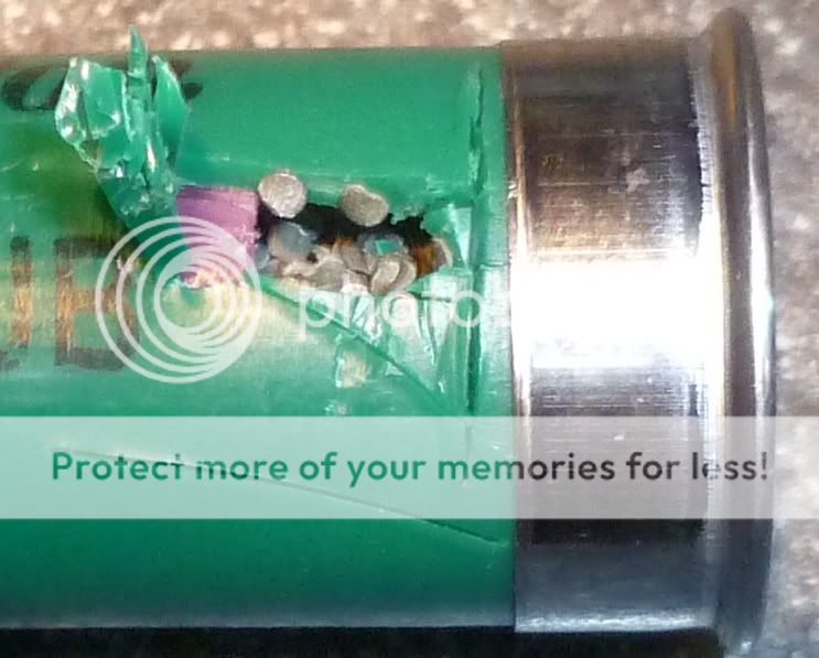

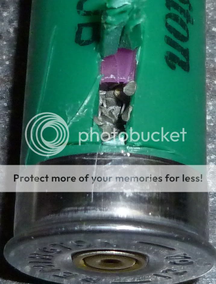

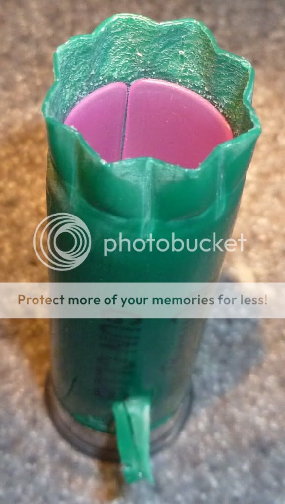

With it's thicker powder cup lip, the edge of the powder cup on the CB2118-12 will bind a bit higher up on the beginning of the hull taper making a bit more of an air pocket between the powder cup and the powder with 17.7 gn's of Clays than perhaps other wads probably would. However, I don't think that it would affect ballistics enough to be noticed.
The upshot is, that in this configuration, it provides for pretty much the proper stack-height shot cup wise requiring little to no wad pressure:
