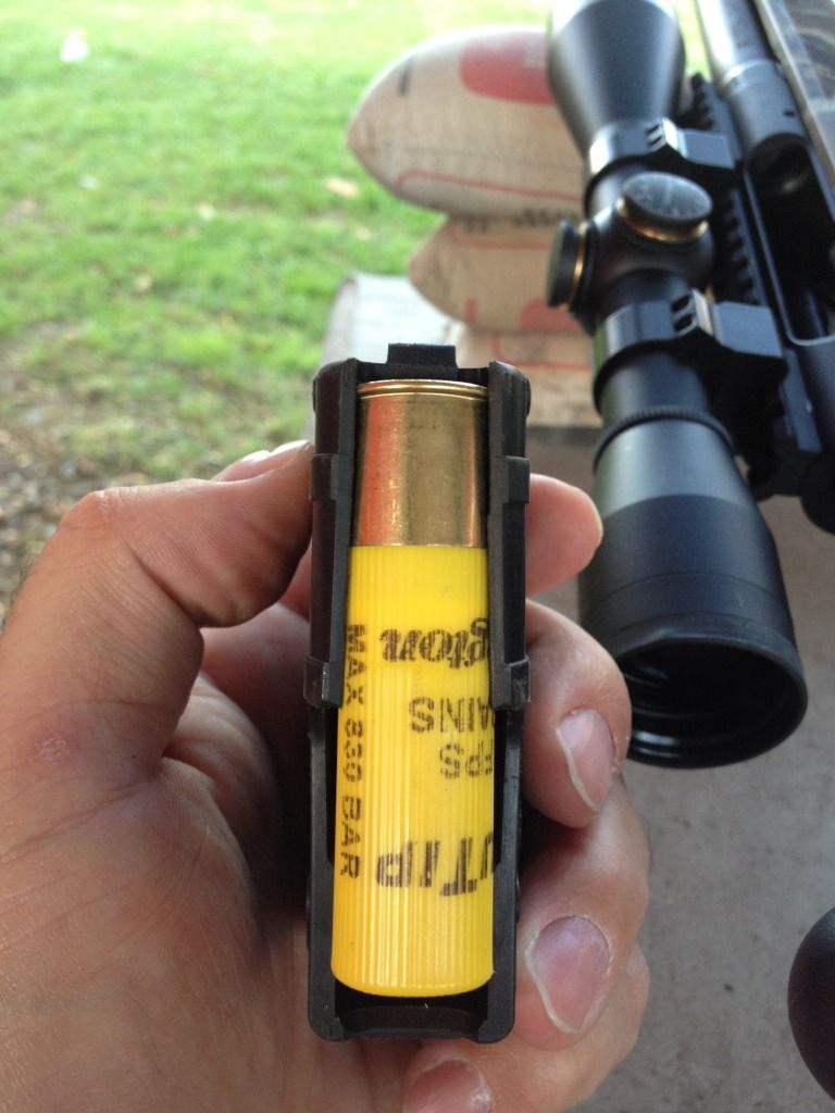

I just returned home from a local range sighting in my new 220. I took 8 boxes of Remington Accu-tip 2 3/4" shells. I would load a shell into the chamber and then insert the magazine with 2 shells in it simulating a hunting situation. It started off cycling shells out and in real well but after maybe 8 or 9 cycles of 3 shells per cycle the gun would not chamber another shell into the gun. Fire the shell in the chamber, cycle the bolt (shell flies out great) but the next shell would hang up in the magazine. Looking down into the chamber with the bolt back, when I would move the bolt forward the shell wouldn't budge. The shell was so stubborn that when pushed on by the bolt the front of the shell would go down. This happened to me 3 or 4 times. When I pull out the magazine to inspect it felt like the shell was hanging up on something with the brass ring on the shell. It was all I could do just to get the shell out myself. It also felt like the plastic lip on the top holding the shell was very tight. It was odd because it was random. Most of the time it would cycle a new with ease. I think I'll talk to Savage and see if I can just get a new magazine. Any thoughts?

Same thing happened to me last season, I believe the issue was the brass ring on the top shell got behind the brass ring on the bottom shell, with the pressure on it from the spring there was no way it was going to feed. I had a heck of a time getting it out. I don't know of a solution other than being careful when loading the magazine to be careful not to push the top shell into the mag to hard.
That makes a lot of sense. It really felt like the brass lip was hanging up on something. I have another magazine coming anyway so I'll have a quick reload. :)

You know that actually makes sense about not pushing the top round too far back on a rimmed shell underneath it. Good advice thanks! Now I just need to get one of these.

I have the same issue with my new 220 using the 2&3/4" slugs. Image

I have a 210 converted to 20ga. I would asume that the feed system and follower are the same, even though they are located in the detachable mag. I looked at a friends 220 and they seemed similar. I had many feed issues and found i had to bend the feed z spring below the follower to allow for proper feed. It was too strong to begin with, the front of the feed (toward barrel) having way too much force. It needed to be very light, too much and it jammed. If you can take it out, bend the front intersection together to give it less strength and push less on the bullet end of the slug. That is what worked for me.

I had the same problem. At first I thought I was shoving the second round in too hard and forcing it behind the lip of the first shell. Finally I realized it was happening upon recoil of the first round being fired. My fix is this, I load two in the mag & none in the chamber before getting in my stand. Once in the stand I chamber one and hunt with only one in the magazine. It's only two shots but it seems to function flawlessly this way. I'd rather have three I'll admit but I hunted for years with a single shot H&R so I can deal with it.
