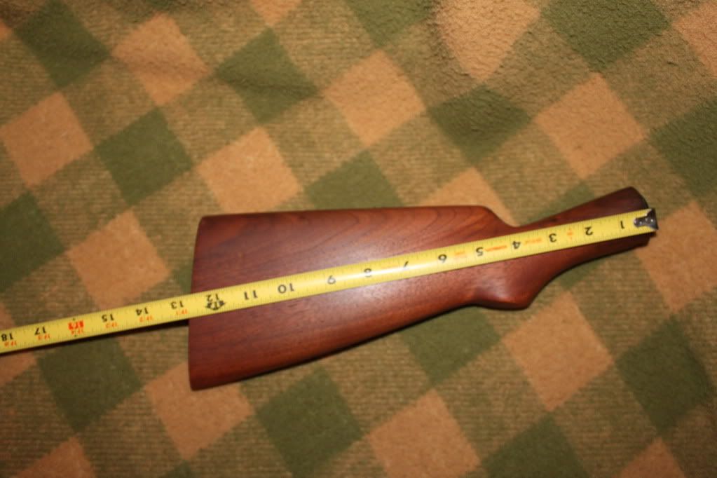

My question is whether to have the checkering freshing up or recutt. I have a prewar set of skeet wood. The set is solid but the checkering is really worn down. How much would I ruin the value if this wood set is recheckered and reoiled. This probably should be in the restoration forum, but I respect the winchester experts on this forum I am attaching a picture for review. Since it is so worn, its value may already be ruined.

I could be mistaken here, but looking at your pictures and bringing them up to 400%, both the stock and the forend appear to have had a coat of varnish applied. . It shows up in the checkering. . As I said, I could be mistaken from just looking at pictures. . If the finish is original and the checkering is just filled with hand sweat and dirt; you may improve the checkering from cleaning it out with a tooth brush and cleaner. . You may have good results from masking the rest of the stock off and cleaning with a tooth brush and methyll hydrate or even acetone if your very careful. . Once it dried off, tooth brush in some extra refined linseed oil, very sparingly.
