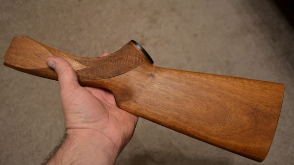

First off the thing was filthy, the wood was very rough and it had rust starting all over.
if you look closely you will see that the barrels were not locking up all the way, as the locking bolt is standing proud. It fell at some point and mashed the checkering on the left panels and actually took a chunk out of the forearm.

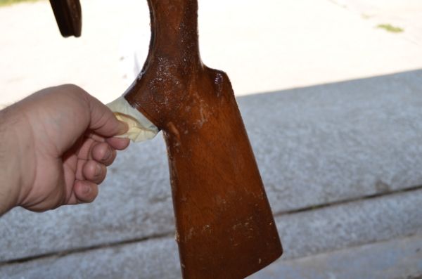

The first order of business is to tear it down and see what needs what?
I know for a fact that the wood has issues and will either needd to be restored or replaced.
Since this is a budget project, it will just be strip, clean and refinish.

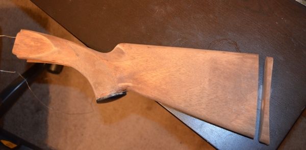

As you can see I also began fitting a Kick-Eez pad. I use and reccommend them highly.
After a good sanding to remove any issues, the wood gets some Watco dark Walnut Danish oil.
