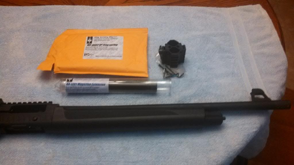

Alright, After finally receiving the extension from Kings Armory... (I chose the snailmail USPS Free shipping version - don't advise) The threads are perfect! I will, tonight make sure all is right and post some pictures.. But I think we have a workable +2 extension. I'll make it work and post results and any modifications I needed as soon as I can. Joey In Tech there was a huge help! THANKS NHShotty & JOEY!
King's Armory KA-LE01 KA-LE01 magazine extension

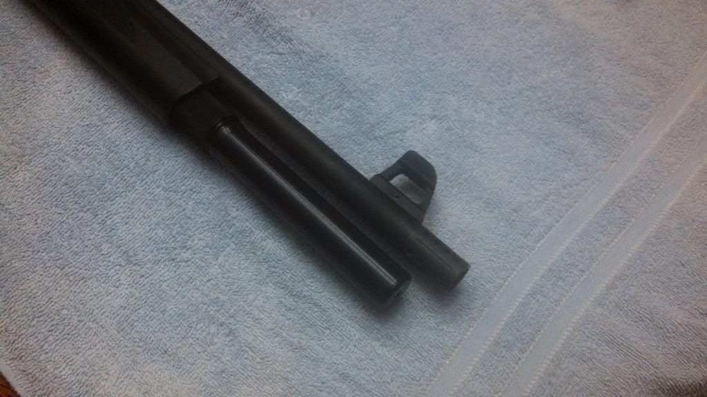

EDIT: Ok guys, Looks like I'm going to need to take about 1/8" off the magazine tube in order to make this work, but the threads are good match so I don't see any issues with this being a great fit. I am going to run another few boxes of shells through it before performing (altering) to make sure I don't have any warranty issues, that Tristar might reject should I perform prior, but, this extension will work with the minor modification. I'll post results in a week or so
Sorry for the delay. I Ended up not cutting the magazine. Lathed myself a small brass bushing exactly a 1/4" heigth 1" ID and 1-5/16 OD fit between the forestock and extension with about a 1/8 of a turn for tension and perfect alignment between the extension tube and magazine tube. worked like a top...new spring and voila 7+1 capacity. Test fired it yesterday and all is perfect with no alterations to the weapon.
