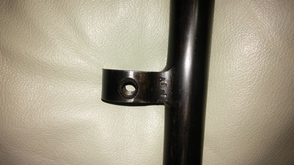

Here are two lightened 16 gauge barrel rings. The first is from an early version.
Sorry I don't have pictures of the lightening cuts in the receiver, but there are two half circles milled on either side.
