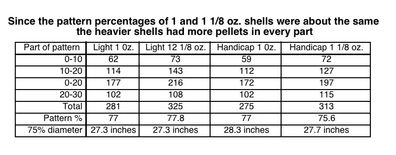

More shot of the same quality means better patterns every time. As a result, the 20 gauge is clearly inferior to the 12 gauge and 1 oz. loads are loudly inferior to 1-1/8 oz. loads.

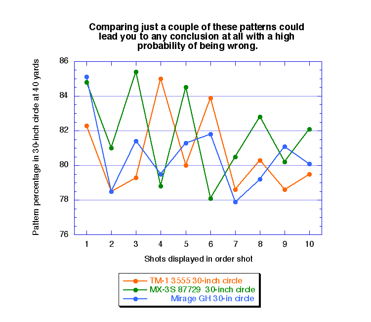

To have reliable average pattern data takes at least 10 patterns. Even then, once in a while, the results can be misleading . . . and it takes 20 patterns.
