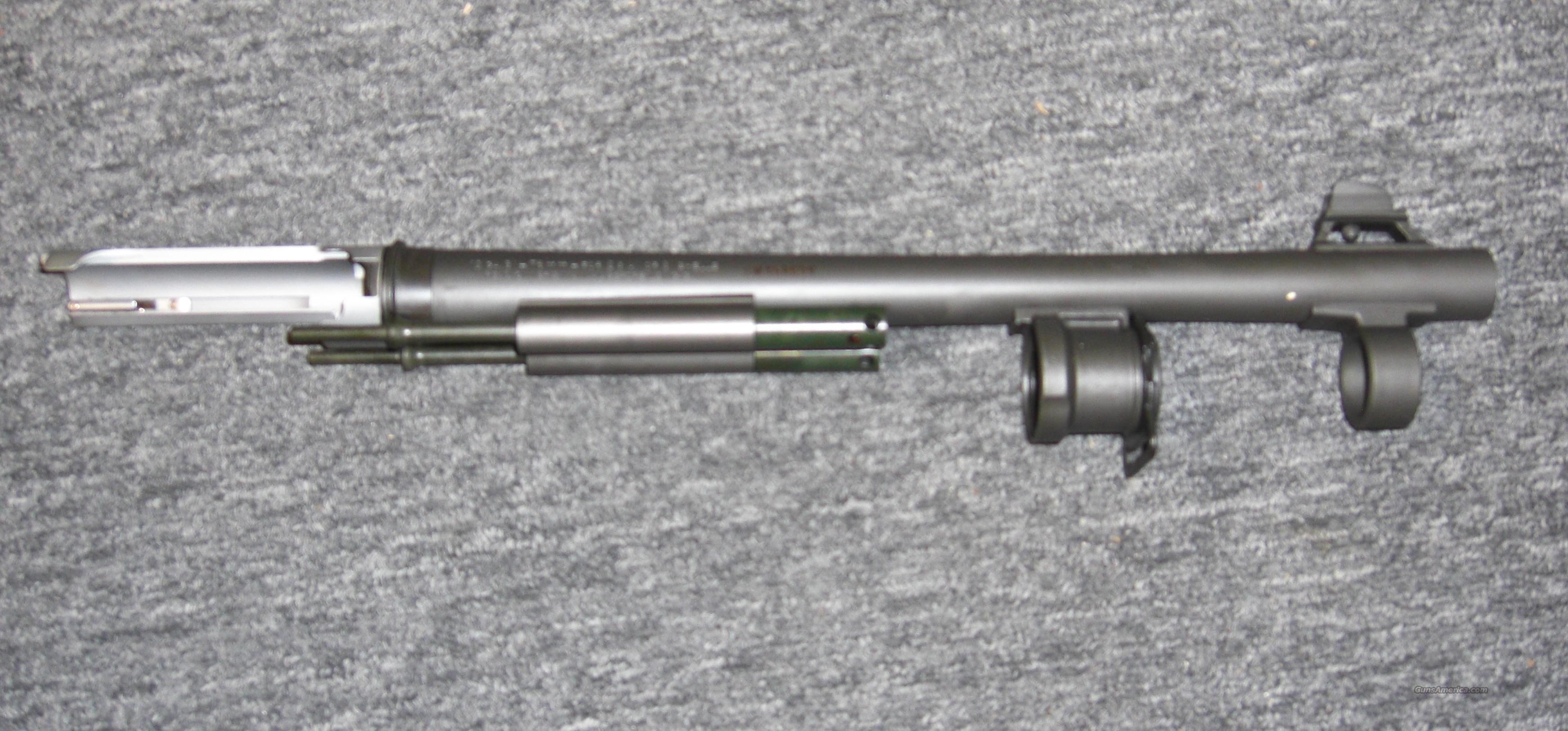

I just realized this is a simple jet engine. The acceleration of the mass of gas out the front would have the ol’ “equal but opposite reaction” on the piston. Clever...

Yup, I read your article. The ARGO system uses a pop-off valve much like the synthetic V3. However, I was more intrigued by the workings of the new system with the open tube in lieu of the pop-off valve (or a simple plug like the VersaMax). I haven't seen one in person and was hoping for some insight on the physics behind it.
Assuming it does work on the 'jet engine' principle, fine-tuning the length and diameter of the exhaust tube would be akin to the use of adjustable nozzles on fighter jets, with the correct nozzle setting producing maximum thrust. Kinda makes sense, but I'm still not sure how that would react to different pressure regimes produced by the wide variety of available shotshell loads. I'm not doubting that it works - just would like to understand how.
If you haven't had this conversation with Remington engineers, there's no shame in admitting as much. No need to repeat the "The V3 is the best ever" mantra again - I'm already a believer. :lol:

Bug Doc wrote:
Hey Randy,
If the long vent tube is truly just an open tube, how does enough pressure build in the gas cylinder to operate the pistons? The pop-off valve in the original is self-explanatory, but an open tube?
An open tube isn't new: it is what is used in the original Remington patent US8065949B1, filed for patent on May 24, 2007, claiming priority over the Benelli patent filed a year earlier. On November 29, 2011, it was awarded to Remington.
The Versa Port system is the intellectual property of Remington, it has been for many years, and has nothing at all to do with any mythical expired patents of Benelli.
Dismissing a tube as being a "straw" or "just" an open tube isn't quite right. What is pipe? What is braided high-pressure hose? Gas lines? What is a shotgun barrel, other than a tube?
There are standard calculations for the basics of flow rate of compressible gas, based on the diameter of the hose/ pipe / tube / straw / barrel, the pressure, and the friction of the gas. There is no reason to overthink it.
There are countless variables: Remington can change the number and diameter of the Versa-Port barrel ports as they wish, the diameter of the dual gas pistons, and on and on. It has been done constantly with more common gas-operated actions: one port in the barrel, or two, different gas piston diameters, and so it goes.

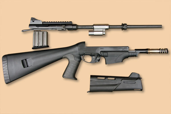

My MR-1 is an "Argo" action as well: just one gas piston.
It is hard to mistake the V3 for an MR-1.
The V3 has gas ports in the chamber, the M4 does not. That's all the difference in the world.

RandyWakeman wrote:
Bug Doc wrote:
Hey Randy,
I think we're referring to different tubes here. I understand how the Versa Port system works. I'm actually referring to the 'exhaust tube array' you mentioned in your post above.
The original Remington patent you cite shows the end of the gas cylinder being closed by a plug they refer to as the "gas diverter and cap [item 20]". Once the piston has reached the end of its stroke, a "gas bleed slot [item 120]" is exposed and the used gas is exhausted. This is consistent with how the VersaMax is constructed. However, based on your photograph of the gas system of the walnut V3, it appears the solid 'gas diverter and cap' have been replaced with an open exhaust tube. Also, I do not see any 'gas bleed slots' on the new system. Am I correct in assuming that the exhaust tubes are open to the gas cylinder? If so, then this system works more like a jet engine than an enclosed piston engine. That's the part I find fascinating. The elimination of gas bleed slots in the side of the cylinder would alleviate the blow-back people are reporting. It would also reduce the number of moving parts (i.e. the pop-off valve in the synth V3) that can wear out or get gummed up. It's as elegant a solution as the original Versa Port idea itself. :D
I may have to go down to the local store and examine one in person.
Ta-da!
