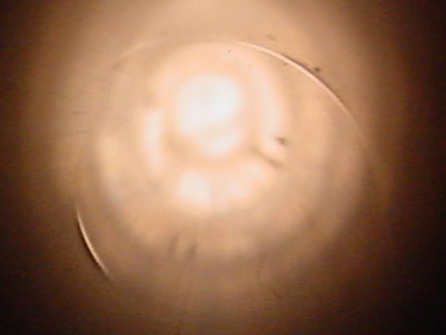

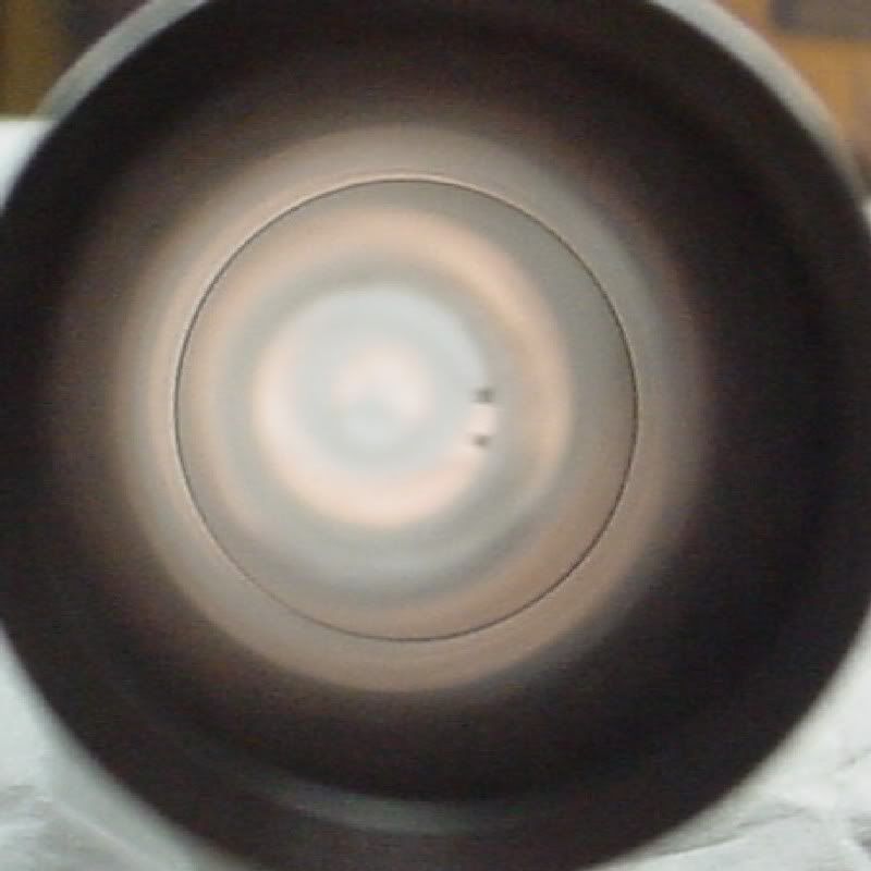

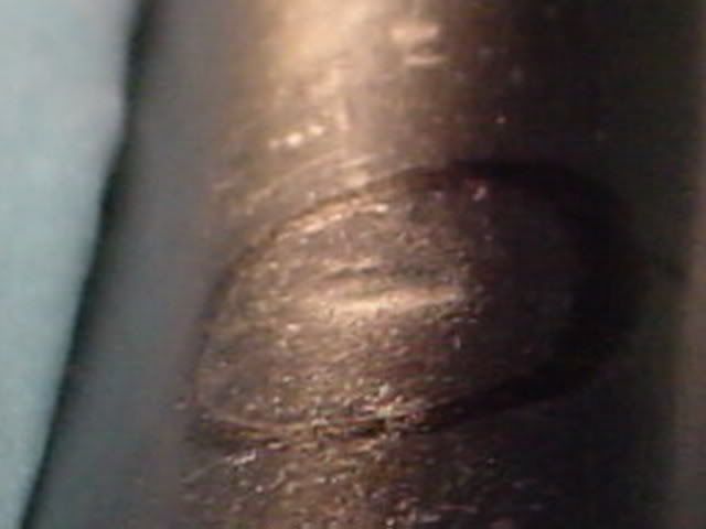

Did you happen to see this?
This is from a previous posting of mine here.
A barrel dent can make a sympathetic bulge appear on the adjacent sides of the dent by causing a localized pressure increase that finds an avenue of relief, if the barrel material is thin enough. Some people may try to shoot out a dent, thinking that a shell can form the metal back out into place, but then the metal has other ideas that they didn't consider.
Naturally, I have some photos to show a little of dent removal.
First, the dent(s).
Outside: before
Inside: before (see 2)
Left dent, inside view
See left dent is practically invisible
Outside: after
Inside: after dent removal, hone, and choke tube installation
How does that look?
