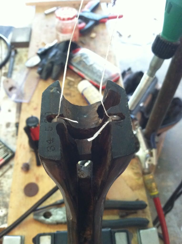

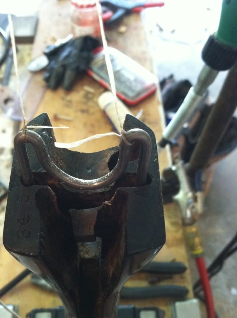

Making the repair properly must include diagnosing why the crack occurred in the first place.
Often times the receiver is no longer making full contact with the stock.
So in my project I pictured above there were steps you didn't see. In addition to inserting the staple as reinforcement I cleaned up all the inletting and glassed the receiver to the stock to ensure full contact.
Acraglass or a CA glue might yield better results depending on the crack.
Since you are refinishing the stock you could try getting some of the oils out of the wood either with the acetone trick ( which I can't really help with, sorry) or by using a whiteing material to try to leach it out.
Either way once you start saturating the stock with things it may swell and require some inletting work to get everything to fit again.
If you have specific questions you could feel free to email me and I will try to help.
Thanks, Doug
