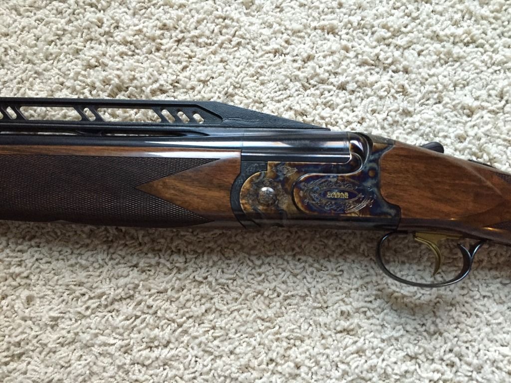

Picked up a new Summit Limited on March 28, and after updating with a 3/4" Add-A-Rib, and new Kick-Eez recoil pad with spacer for 15 3/4" LOP, I took it out today for it's first run on my local sporting clays course. Photos are below. I have an Add-A-Rib on my other guns: CZ Sporter, Fabarm XLR5 LR, and now the Summit Limited. I tried to order a Summit Limited (I wanted the Deluxe wood CG build it with), but with a Summit Ascent barrel with a mid-height rib. I'm 6' 5", 235 lbs, and shoot fairly upright, so I need a lot of drop along the comb. Most gun makers, and most faces and bodies, must be different than mine, because I can't just pick up an off-the-shelf target shotgun and have it come close to fitting well. Well the Summit/Ascent combo still didn't provide enough drop, so adding an Add-A-Rib was necessary again. My CZ and Fabarm both have Monte Carlo stocks, but this time I really wanted a basic sporting stock. The gun is nice, and I really like the case hardened receiver look as well. Shot 130 rounds today, and it felt pretty nice. I'm still getting used to it, especially the nice light trigger, that scared the crap out of me about three times today because it is so smooth and light I triggered the gun before I was ready - hit 2 of those 3 though  . I can get used to it, but it'll take some time. Total shot count for the Summit Limited = 130.

Nice looking gun. I'm not a fan of the case hardening finish, but different strokes...
Did you install the Add-a-Rib yourself or send it off to be done? I assume these add-on ribs come in a variety of heights? What height is yours? Looks to be about 3/4" to 7/8".

Ulysses wrote: Nice looking gun. I'm not a fan of the case hardening finish, but different strokes... Did you install the Add-a-Rib yourself or send it off to be done? I assume these add-on ribs come in a variety of heights? What height is yours? Looks to be about 3/4" to 7/8". Hi Ulysses - I installed the rib myself, and it's 3/4" of an inch. I was surprised at how much I needed. My CZ Sporter and Fabarm XLR5 both have 3/8" Add-A-Ribs. I haven't measured my modified Summit Ltd. yet for drop at comb and drop at heal, but my other guns are set so I get nearly 2" DAC and nearly 2 1/2" DAH (or back of Monte on those guns). I played around with a prototype raised rib I made for my CZ, using the magnets and adding more magnets to raise it until it seemed about the right height. To my surprise, my 6' 5" frame and long neck required 3/4". It feels great now. Pat Lieske helped me set it up at my home SC club by adding a spacer and Kick EEZ recoil pad to get about 16 5/8" LOP, and I'm anxious to shoot it more.

Beautiful gun. Unlike many other "Add A Ribs" I've seen.......yours looks like it belongs. As a matter of fact, I took it for a Summit Impact at first glance. Good luck with your new purchase.

cheecho1960 wrote: Beautiful gun. Unlike many other "Add A Ribs" I've seen.......yours looks like it belongs. As a matter of fact, I took it for a Summit Impact at first glance. Good luck with your new purchase. Thanx cheech - The guys at Add-A-Rib have different rib configs they try to make fit the various existing OEM rib designs. I'm really happy with the looks. Most people tell me the same thing you did, that it looks like original equipment.
