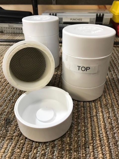

A member here, icyclefar, once posted specs for a sifter that used a certain screen and come PVC pipe parts from the plumbing section of the home depot. The place I ordered the screens from had a minimum order so I used the extra screens to make more of the sifters. I gave the extra sifters to some friends who also reload. Mine sits on my bench and whenever I need it its there. See if you can find it. Nifty, compact, cheap, and, best of all, home made.
Thanks for the mention. Here is the information for the sifters that I put together.
icyclefar wrote:
Holly thread revival!
So for years I've had the sifter that looks like a shotgun shell sold through Precision Reloading.
It works well, and is handy to have on the bench. Capacity is really only a single shell's worth of shot/powder mix.
I've had a few shooting buddies take the plunge into reloading and both had tried finding themselves a shot sifter, they seem to be gone from Precision reloading web site now.
So I got to thinking, and with a little google searching, came up with the materials to make my own.
For anyone interested, here is what you will need.
PVC cleaner and cement
One 2" PVC repair coupling. (make sure it is a true repair coupling without any internal lip)
Two pieces of 2" PVC pipe cut to 1-3/8"
Two 2" hub caps (hub caps are flat and shorter in overall length than a standard cap)
One 2-1/2" round stainless steel filter mesh screen, #14 mesh with 0.020 wire
I start by setting one section of pipe to the center of the repair coupling and glue in place.
Insert the mesh screen into the opposite end of the repair coupling, because the screen is slightly larger than the ID of the repair coupling it will dish slightly, this is a good thing.
I then use a vise to insert the second section of pipe, glued of course, and squeeze it all together pinning the mesh screen in place.
The hub caps simply friction fit in place.
The #14 mesh will capture any shot #9 or larger.
Here's a pic of the finished product.

I had considered dumping the lot into a paint roller tray and letting the shot roll down to the pool, so similar to the cookie sheet approach.
But I think I have some PVC bits around - I may take a crack at building the sieve icyclefar described.

Icyclefar gave me one and i had not needed one at that time. Within a week i did!! Works great and is good to know it's on the bench if needed.
