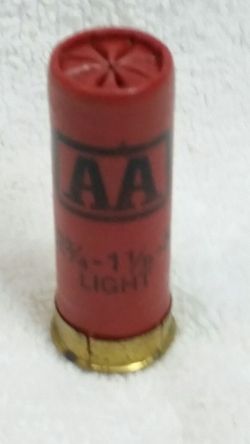

Over the weekend had a AA hull where the brass head separated from the hull during ejection in my wife's beretta 3901RL. Scary part was it was first round of a report pair. The gun tried to feed the second she'll, luckily the hull from first round wouldn't go past forcing cone and prevented the second round from clambering
I bought the factory shells and have reloaded 3-4 times. Win209 primer, 1oz lead. Claybuster waa12sl wad 17.6 gr claydot. Loading with PW800+
The hulls looks fine prior to reloading
I'm concerned this could have been bad.
Any ideas on what caused the brass to separate?
Ways to detect before this happens again?

I tried to load this shell, but gun would not close. Upon examination, the brass is cracked in two places. This is a once-fired AACF hull.
