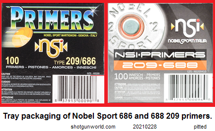

Would you swap Nobel primers for Winchester and Cheddits?

I have shot a lot of Nobel Sport primers. My experience, the 688 is the one
I prefer, never a problem, hot or cold weather, although I have not been in
the really cold stuff.
I shot about 15,000 of the 686. I never had a failure one time, but the
primer seemed to be "cold". It took more powder to get the velocity than
what the loading tables indicated. Also, I had wide velocity swings on
low pressure loads in cold conditions.
From my experience, I suspect you have to add a little powder in the
cold months, to get the pressures and velocities you want. This is
probably true of any primer, not just Noble Sport.
If I have a choice I take the NS 688, but I have not shot it in really
cold conditions. I suspect an extra half grain of powder will not
hurt in December. Actually it probably won't hurt in August either
but it will give more velocity than what you expect.

Joe Cool raises a key point. Are you asking about the 686 primers or 688 primers?

686

I have loaded them for a long time, both 686 and 688. I prefer the 688 as it seems a little "hotter". This is my go to primer for loading Rio target hulls of which I have a large supply.
These are large enough to fit well in the Rio hull, as the Cheddite and Fiocchi primers will sometimes fall out.
My favorite load:
Rio 12 ga target hull, low brass
21 gr Titewad
NS 688 primer
Claybuster CB 2100 or 6100 wad
1 oz 7-1/2 magnum shot.
