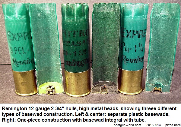

Considering only 12-gaiuge 2-¾" shells, Remington in fact produces two hullls besides the "unibody" type. Here's a photo.
Two of those shown have separate basewads, one yellow and one black. Remington uses these for loads that require more internal volume than the unibody type. The hulls on the right in the photo are of unibody construction and will load with the usual data for Gun Clubs, STS, Nitro Golds, etc.
The hull with the yellow basewad is pictured on page 33 of Lyman #5. Data for reloading the hull can be found on pages 152-154, 306, 341, 356, and 384.
I have found no data for reloading the hulls with black basewads, but because the difference in basewad height is trivial, the loads for the yellow basewad hulls should be acceptable.
As far as I know, the hulls with separate basewads are all made with taller metal heads ("high brass").
These high brass hulls are not commonly found on ranges that emphasize clay target shooting. My local club is pretty rural, and a lot of users try out buckshot, slug, turkey, and other types of loads, so they are found here frequently.
