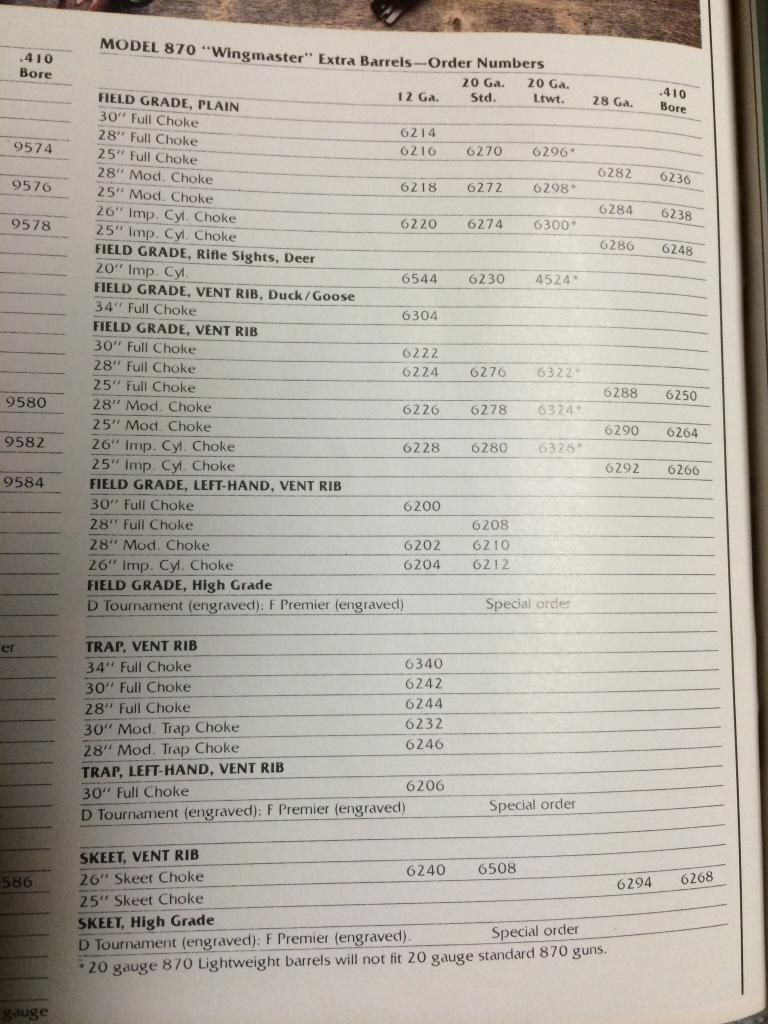

I have read this statement about 10 times and I'm still not sure I understand it. Are you saying that you can interchange standard and LW barrels on the same receiver? My memory doesn't function real well going back 30 years, but I thought I remembered Remington stating that you couldn't interchange the standard and LW barrels...could be wrong though. I fully understand about the ejector and the ejector spring.
Ok, I found what I remembered in an old 1982 Remington catalog.
See the asterisk at the bottom of the photo. That's probably what you were saying all along, excuse my lack of reading comprehension Virginian.
Chris
