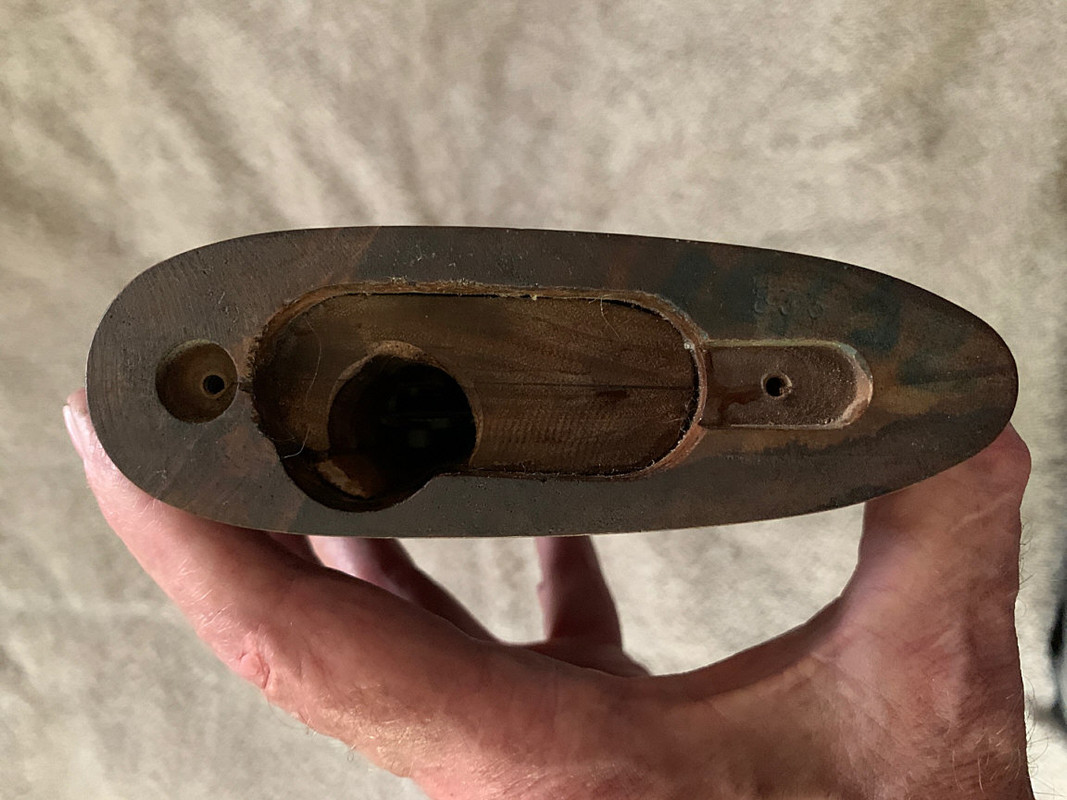

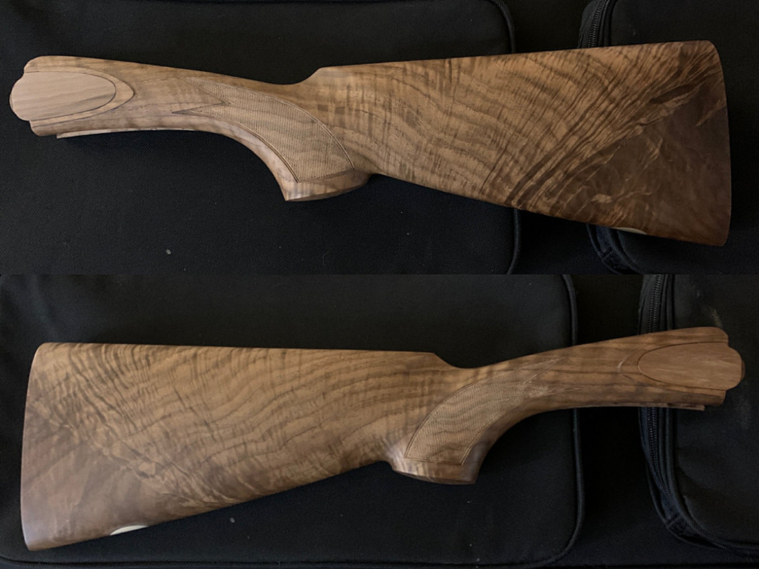

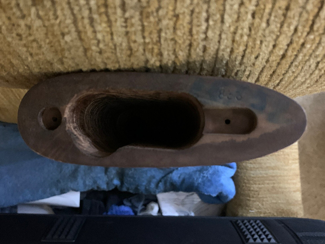

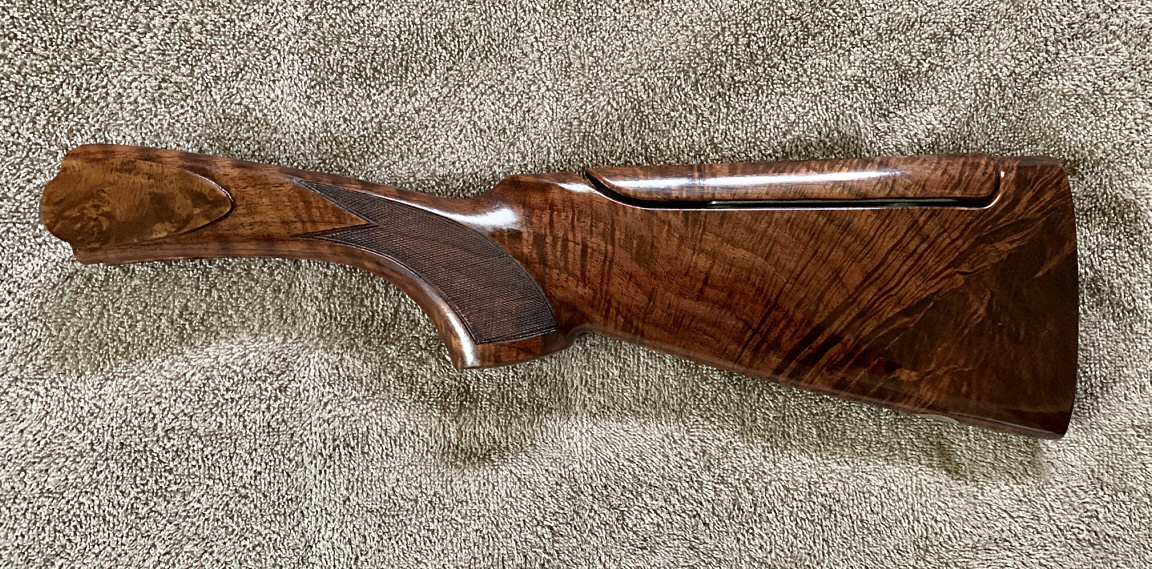

The problem with fitting an adjustable comb on a Beretta Field stock isn't than they are too small, it's the giant cavity within the stock. A cavity that can be filled with an hand made insert. A bit of hand shaped Walnut epoxied into the did the job. Note, I intentionally dropped the mounting hole a bit because on the Sporting stocks the hole is high enough to weaken the support area for the comb kit a bit. The Sporting stocks don't have any cavity at all, just a hole for the mounting screw.
Then, if you are working with a NOS stock for a 687 EL there is a matter of filling in the inletting for sideplates. Then a bit of Burl Veneer was used to cover up the fill in job.
Once that is all in place it was they a simple manner of applying a touch of stain and finishing the stock with many many layers of True Oil.
Must say I am quite pleased with the results, this stock looks lovely on my 686 Silver Pigeon I. Note, purchased the stock from MGW and it is old enough that it was a fully hand checkered stock. I'll also note that a member at my club will do this complete job for 300 dollars. Hindsight says I would have been wise to let Lou do mine but I happen to enjoy working with wood. As for your cast question the Silver Pigeon stocks typically have very little cast as do the Field models. However if you get into the high end Sporters the cast is rather large, I purchased another adjustable comb stock from MGW for my 12 gauge for a 682 Gold E and it has a nice palm swell and a rather large cast of somewhere in the range of 3/4 inch or bit more.
