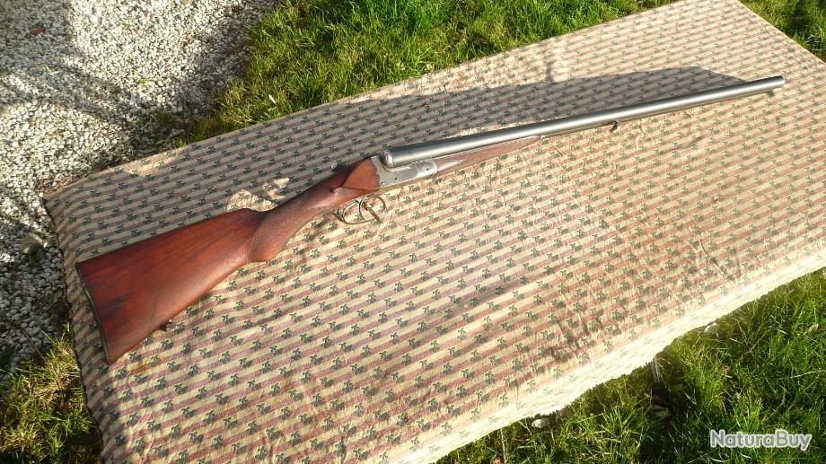

Just a bit of an add-on.
A similar gun is being offered on-line in France for 400 Euros; call it the same-ish in dollars. Similar A & D scalloped action, drop points, gold inlay and general appearance, but without the side clips. This one is 70mm rather than 65mm and has sling swivels which might look a bit strange to American eyes, but is common on French hunting guns.
Riberac is a delightful small town in the Dordogne in Perigord a big hunting area, notable for waterfowl and wild boar. Be a surprise if your gun hadn't toddled around it at some time.
Not a clue about dates I'm afraid.
