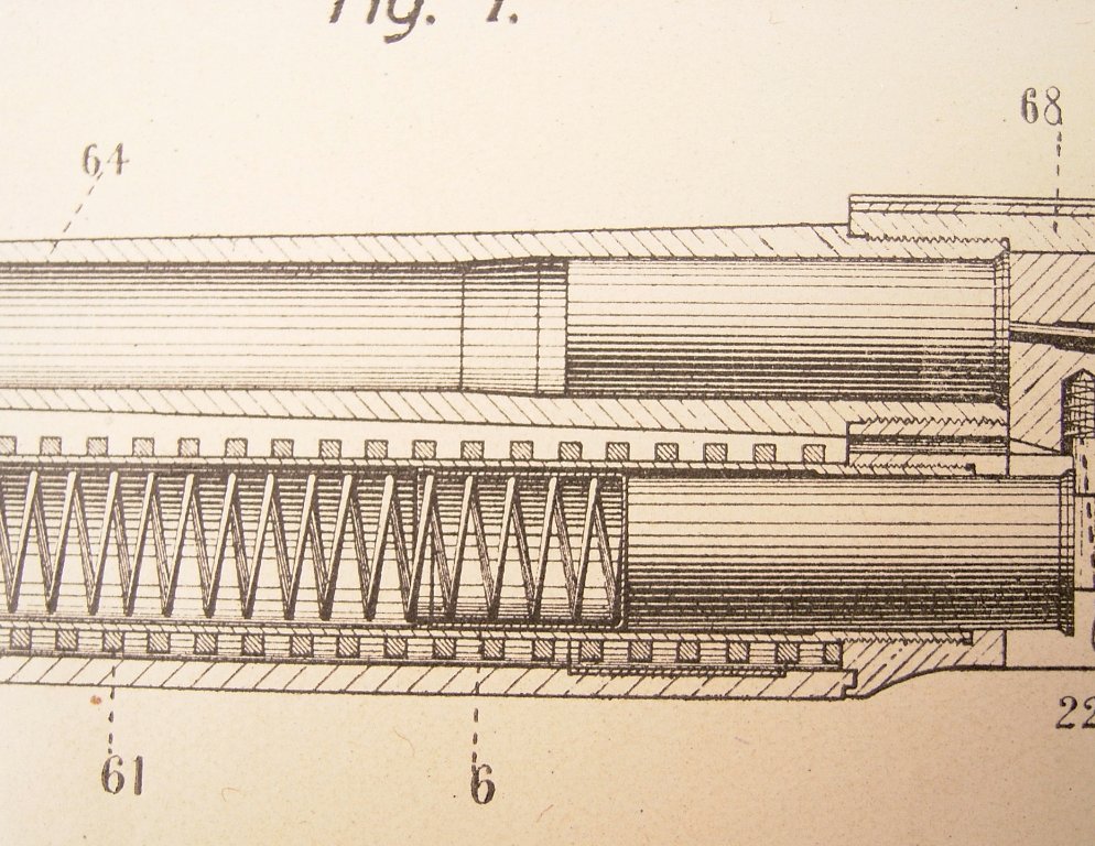

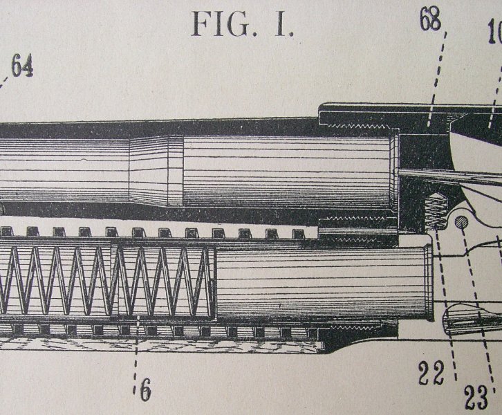

Well, just recently, I bought an early FN manual for the A5 which was exported to Australia (an Australian address of the former owner is present). No printing date, but I’m quiet sure, it was printed between 1909 (both the 12 ga. and the 16 ga. are shown) and the outbreak of WWI.
What is most interesting is a large foldout showing sectional drawings of an A5. There, you can clearly see: a recoil spring having a square cross-section.
The question arises, when the change from square to round cross-section occurred? Before 1923 I guess, but this is just a hunch.

In all Browning patents where the recoil spring is visible they are shown with square cross-section, e. g. Browning’s US patent # 689, 283 of Dec. 17, 1901.
FN started production in 1903 and the ultra-early A5s do have all features John M. Browning designed. Also, the Remington 11s strictly followed Browning’s specifications.

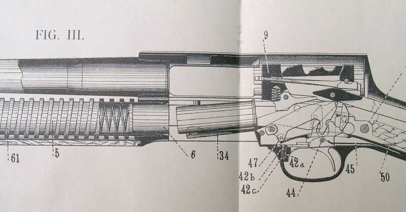

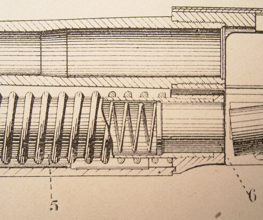

Just recently I received another A-5 manual. This time, a German language manual dated May 1929.
This manual often is offered as a reprint, but mine is original. In the appendix is a large fold out showing cross-sectional views of the A-5.
The interesting part of that: while the upper figure I shows a square spring,
the lower figure III shows already a round spring.
Thought, you liked to know.
Best regards
