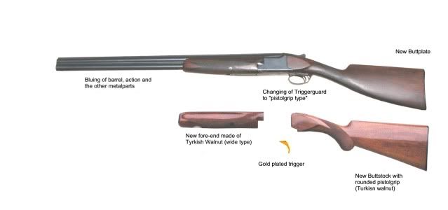

I had long been looking for a Browning from the "old" Fabrique Nationale (FN) in Belgium.
Finally I managed to grab one, so this "Game gun" from 1969, became the starting point for my "Superposed project" :D
Project Plan!
My plan is to make some changes so that the gun seems to fit me and my "strange" perception of how a FN Browning should look like.
I would however humble respect for the original designs, choose to hold me close up of a contemporary models.
mvh.
Swift

Well maybe I just got a poor taste. :)
I think a side by side is beautiful with a strait stock, but I don’t think it suits an O/U! – But ill keep the original stock and fore-end so it’s possible to changes back.
I got an old (1963) Superposed as a loan. I’ll use it as model for the new stock, made of Turkish walnut.
@ txrick55: no I haven’t shot with it yet.
Swift

I found a blank of Turkish walnut via”Chiron” (HunterBid.com) especially for this project.
The blank was roughly cut so it could contain a rifle stock. It gave me a good chance to choose where I want to place the cutting lines for the shotgun stock, with regard to the grains in the wood.
I made a couple of patterns from the model, and cut the walnut out on a bandsaw.
Swift

I suddenly understand your concerns about my plan about chancing the stock and fore-end.
Its right the value to get an original Superposed as it left the FN factory is gone, but I purchased this gun one and only with the purpose to chance it to a gun that obliged my idea how an FN Browning should be to fit me. But don’t worry, I’ll keep the original stock and fore-end so it’s possible to changes back to the original look.

My next step is to adapt the stock to the action. The tool I use is: Hacksaw – Woodcarving tools and Files
As you can see on the picture, I have moved the centre for the processing, to the left side of the block. It will later give me more room for “Cast-of”
When the parts fit perfect together, I was marking-out, and drilled the hole as went from the action and behind the stock. It’s important to count (if so) with “Cast-of” to get the hole in the centre of the stock
Then the action and the stock can be bolt together from the back with the through-going screw.
The next step is the rough grinding of the outlines. This kind of work make a lot of abrasive dust, so I’ve moved out to my firewood shed. A rough grinding wheel it’s a easy and quick way to bring the stock close to the final shape.
Of course I’m very conscientious by not to get to close and not touching the metal parts with the grinder.
When I feel that the shape is nearly there, I lay down the grinder and go further with chisel and rasp.
Swift
