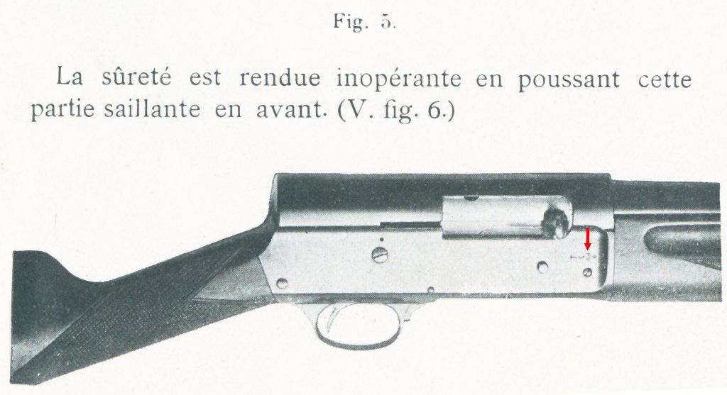

It is true, that there are early 1903 A-5s not having the PV marking and having inspector’s marking star/J (later guns, i. e. 1904 guns do have inspector’s marking star/T). For example, SN 970 shown in Shirley/Vanderlinden is such a gun without PV and with inspector’s marking star/J. The same configuration on SN 2996.
But it is absolutely NOT TRUE, that all pre 1919 would not have the PV marking on receiver and bolt! My 1904 has it, as well as my 1907 and my 16ga of 1910/11.
OK, you could argue now, that my guns (as well as a lot of others with PV) would have been assembled after WWI.
So, check out an image from a 1909 FN manual for the A-5 in French language:
The manual was discussed already here:
viewtopic.php?f=53&t=200676
You see? The PV marking on the receiver is present. This gun has the same features as yours, btw. This is a period publication, published long before WWI.

Nope. 1904 until 1909. The patents are clear, the above mentioned manual is clear, my own #12400 also is clear. Especially the manual is an important source, as there clearly is stated: “all these improvements [e.g. safety type 2 and magazine cuttoff] can be found on guns with serial numbers from 14,000 on”. SN 14,000 was made in 1904….
Next: IF assembled after WWI: why should have FN used the type 2 safety???? They already used the type 3 safety since 1909……
