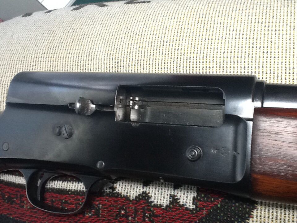

Newbie here:
I just acquired a (what I've learned from this forum) a 1928 Browning
A5 with all original parts and furniture. The S/N is 1144XX with a sideways
small g on the barrel in the "10" date code position. It is an 18.2 18.3 choke
and smokeless powder approved H P V on the barrel. Barrel is solid ribbed
and stamped Browning Company Ogden Utah. It came with 100 rnds of
Winchester Ultimate 12Ga 7.5 shot ammo. I'll clean it and lube it before
I get home to Tucson and a chance to shoot it. 12 Full Special Steel barrel
stamp.
Should I keep this old gun original? I paid next to nothing for it.
Thanks,
Mick
Tucson/Santa Paula

Hi Mick.
My opinion, for what it's worth, would be to keep it original.
As long as the gun is safe to shoot it would be a shame to lose all those years of patina. It would be like deleting it's history if it were to be refinished.
Regards,
Adrian.

Ade Webb wrote:
Hi Mick.
Regards,
Adrian.
Thanks Adrian,
I have decided to keep it original and just shoot it when I get it home
to Tucson.
Mick

I put about 20 rounds through it last wed. at the range. Shoots like a new gun. I cleaned it and put a little lube on the magazine tube before shooting. Not a single failure and very nice recoil.
I also have a 1953 "pretty" version of the same gun which shoots well but kicks just a little more
than this one.
I cleaned it and put it away in my safe. I'm keeping it just like it is!
