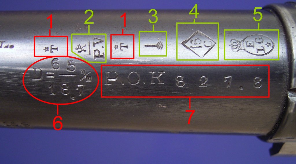

Gentlemen,
as Belgian proofs on A5s are often subject of discussions and questions, I like to add some photos and explanations. Shown are typical proofs on A5 barrels 1903 to 1924 and 1924 to (at least) 1940. I do so, because the proof markings may be very helpful to get additional info on a specific gun.
All info regarding Belgian proofs comes from this site:
http://damascus-barrels.com/Belgian_All_Proofmarks.html
I marked the typical proofs in the photos this way:
Red frames/numbers: variable markings
Green frames/numbers: nonvariable proof markings, which should be present on guns of the relating time period.
Regarding A5s proofs are constant from 1903 to 1924; in 1924 the Belgian proof law and the proofs changed.
Note: from 1922 until present there’s a proof date code for the relating year.

Proofs 1903 to 1924
Shown are the typical Belgian proofs on a 16 gauge A5 of 1910/11:
1 = Inspector's mark which could be any letter of the alphabet. The letter is depending on the time frame when the gun was proofed. E. g. the 1903 proofed A5s have the inspector’s mark “star/J”, while the A5s proofed in 1904 and later will have “star/T”.
2 = Smokeless powder proof (P.V. = Poudre vive = smokeless powderr)
3 = the Perron; indicates inspection or proof of breeching system
4 = Nominal gauge designation applied to shotguns given black powder proof (C = calibre; 16 16 gauge, 12 = 12 gauge and so on)
5 = Introduced to designate arms proved in conformity of German Proof Law of 1891. In now represents definitive black powder proof except for muzzle loaders.
6 = Numerator: Chamber dimensions in millimetres shotguns undergoing smokeless proof. Denominator: Length of chamber over diameter of chamber. In the example given the chamber length is 65 millimetres ( = 2 9/16”) and the chamber diameter is 18.7 millimetres. An other typical chamber length (on 12 gauge A5s9 is 70mm = 2 ¾”.
7 = weight of the barrel in grams when proofed. In the example: P. (= Poids = Weight) 0 (=zero) K. (= kilograms) 827.8 grams ( 1.8 pounds).
8 = Choke
9 = provisional proof of barrels
Another (unusual) example of proofs is a 12 gauge barrel of 1904 made A5 SN 12400:
What’s unusual here is the short chamber length of 65 mm (2 9/16”) and two weights (I have no explanation for the latter).
