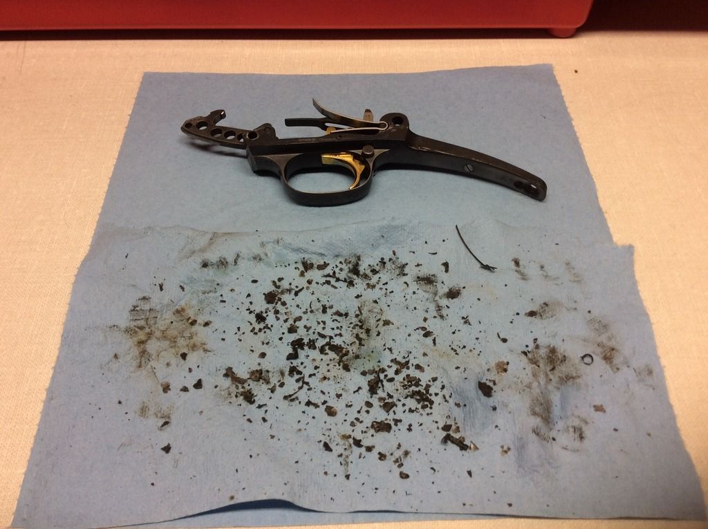

I decided to make my 1966 Lt 12 my next project.
I am still amazed at how well these firearms continue to function with the amount of debris that was found in the trigger assembly.
This firearm was functioning flawlessly before disassembly.

I bought the Brownell's screwdriver set and have this 92 year old gun broken down per their online video.
The serial numbers all match.
Some of the caked on junk is quite old.. the next step is to clean all these parts up. Time to get out the Hoppe's.. or something else to break this crud up!
