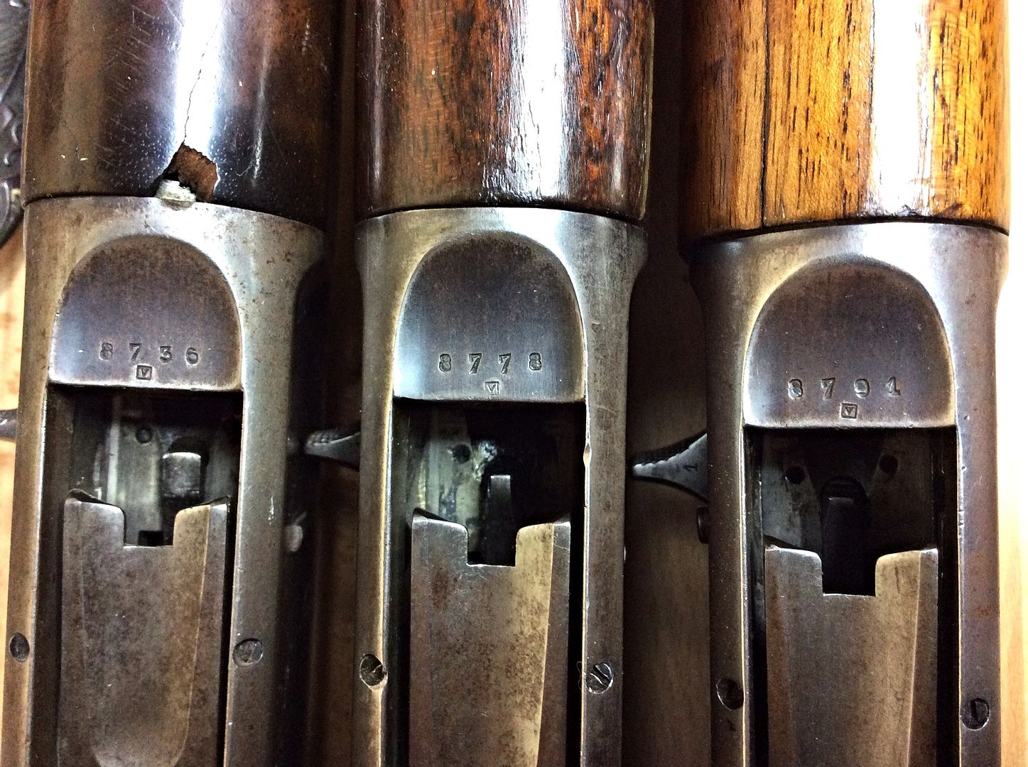

Hello everyone,

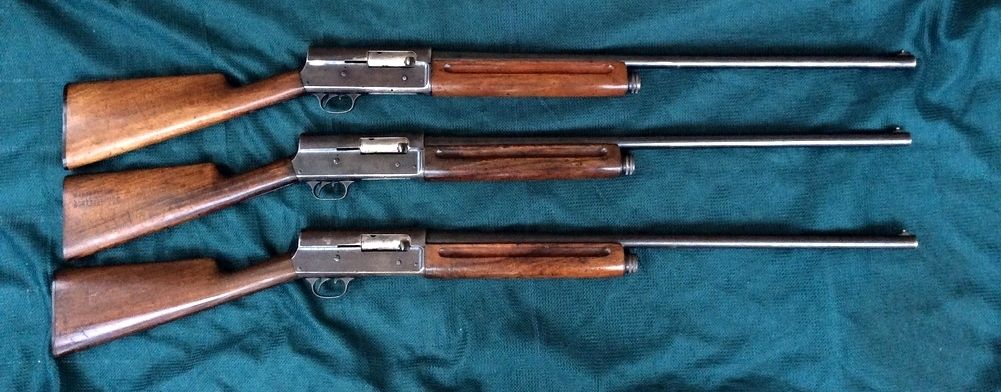

I lately acquired these 3 very early Auto-5, complete with matching serial number.
In addition, it is interesting that the serial numbers a very close. I believe they were made the same week may be the same day.
But the most interesting is the following. The two first specimen have a notch at the top of the ejection window. The third one has none. Is it a defect into the manufacturing process? Does any one have a hypothesis?
Here is a close up of the notch.
 Post subject: Re: Very early Auto-5 mystery notch
PostPosted: Mon Jan 11, 2016 12:42 am
Posts: 3114
Gibier,
Congratulations on your find. You have quite a collection.
I have a hypothesis, and you're not going to like it. It looks to me that the receivers were damaged by the operating handle when the bolt slammed home either with the barrel off or too far forward. The barrel can be too far forward if the magazine cap isn't tight or if the forearm channel is worn.

Thank you all,
Rudolph I would agree with you. Your hypothesis seem credible. 112 years of slamming will make is way into the receiver.

Metal is strongest where it has a crease or an angle, like on a car's hood. These two receivers have a crease/angle where the notch is. Metal normally cracks when pounded from an edge, and will crack in the direction of the pounding, if no other flaw redirects the crack.
Notice the notches have radiused corners and a smooth flat edge. They were machined into the reciever, perhaps as a "just in case" the bolt handle came too far forward if the barrel wasn't screwed down correctly.

I must have a different edition, but gun #7312 shows up on page 61.
Perhaps the notch was an early feature to assure the bolt would go fully into battery, and was found to be unnecessary? Also, a small notch in that location where the receiver walls are thin would be a dandy place for a crack to form.

Interesting. Maybe the receivers didn't crack because "Cockerill Steel" was soft. Or maybe they did crack and the cracks were dressed out with a file. The picture (on page 61 in my book also) shows a similar notch, but it's the only notch in the whole book. If it was an early feature, I think we'd find it on more guns. It's possible theses notches are how Browning found out about the problem of letting the bolt slam shut with the barrel off, and why they caution against it in the owners manual.

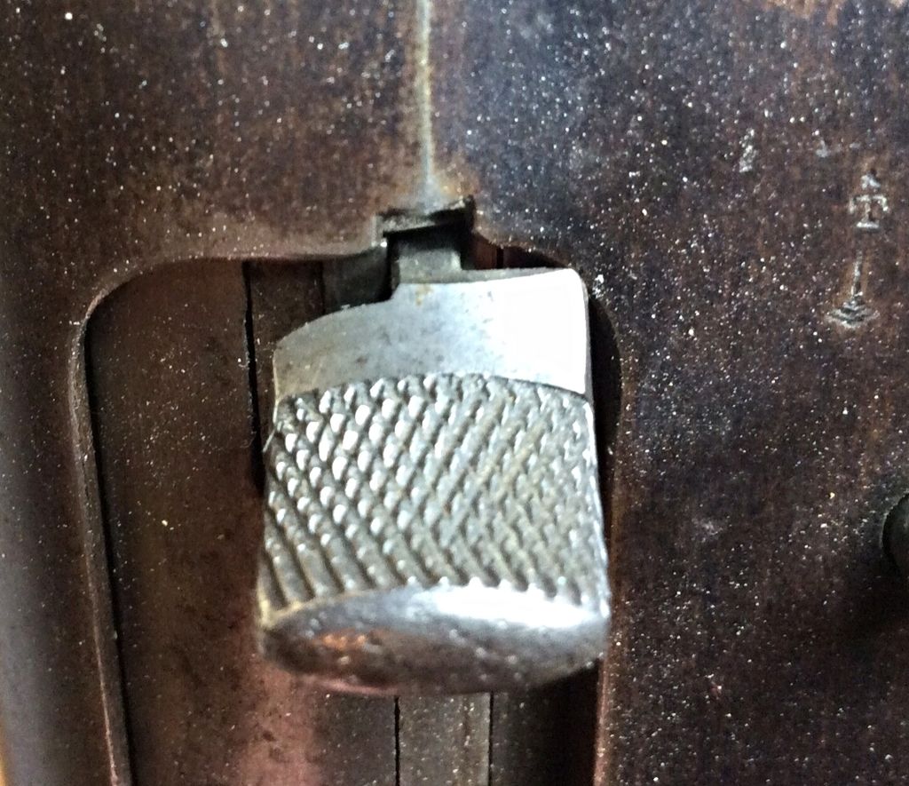

Hello everyone,
This discussion is becoming very educational. I have made a couple close-up of the operating handle and it seem to me that there is two factors that point towards a factory made notch instead of degradation caused by slamming.
The first one being the fact that the notch is wider than the "stem" that hold the handle.
The second, if you look closely where the "stem" ( I don't how to call that part that hold the handle into the bolt) would hit the receiver, it appear pretty clean.

Nicely done, wish my pcs were that clear and focused.

If those notches are factory, I'll have to change my opinion of FN craftsmanship. I'd like to see the same shots taken with the barrels removed.

None of my three first year guns are notched. I would have called them bubba notches but the picture of the notched 7312 gun in S/V seems very clean and confirms another A5 secret is exposed. I wonder if Martin has any info on this variation.

The notches look much cleaner in these shots. Could you please post two more with the barrels off and the bolts forward? I want to see how the operating handle mates with the notches.
