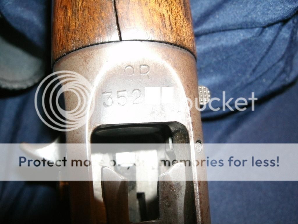

Okay, after reading through this very informative thread, I think I have almost nailed down my new (to me) Auto 5 16g a, as a Post-58 Standard Sixteen. Unfortunately, the first character of the serial number seems either worn or lightly stamped, and I can't decide if it's a 9 (made in 59) or maybe an 8 (made in 58). It's ?R 352XX.
I do wish the Browning site made a little more effort to explain the various letter codes for these years, and I'd very much like to thank those who have posted answers to others in this thread that shed light on the subject.
I'm going to try to add a pic, and I'd appreciate opinions, as I'm sure some of you have looked at far more of these stampings than I ever will.
Thanks in advance.

Looked like a "9" to me. But I went and looked at my collection anyway--only one "8" out of seven Auto-5s--and you definitely have a 1959 gun.

Excellent. Thank you very much, sir.
