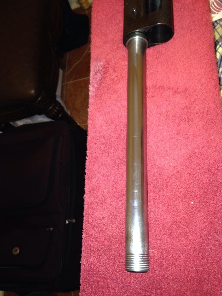

Beach004, no need to consider alternatives you have a great gun that will do it all and not to mention served reliably in WWII. I have several vintage guns that when I first got them would not function properly. I'm
Of the firm belief that as long as the gun is clean and to factory spec IT WILL function as designed. Finding out what is out of spec or causing that malfunction can sometimes be tricky. I own 3 long recoil guns and love them all! Auto 5 mag 12, savage 755a, Remington 11-48. Before we dive into more discussion can you please elaborate and give specifics if what type of malfunction, how often, what ammo ect. New springs (recoil, magazine and buttstock) and rings are cheap and always help extend the life of your gun.
I found it interesting you said it works flawless in warner N.C. But not in colder North Dakota during your hunts. Before you start tinkering and changing out parts consider this. The long recoil action needs to be firm against your shoulder. If your were wearing a poofy jacket the padding would act as a recoil absorber stealing some energy out of the recoil operation, this compounded with another tiny issue together could be causing malfunctions. As far as lube is concerned a little on the mag tube is fine, it's not going to hurt your gun, too much will make it too slick and cause excessive recoil. As far as the temp maybe a thin film of grease or some dry spray on lube. As a matter of fact I'm thinking about using that remington dry lube just so over time a little bit of oil doesn't leak into the wood forend.
Get back to us and we will get your Auto-5 back into action! Make sure there are no burrs anywhere either that would impede the recoil action.
.....one more thing. As these guns are old I have seen some oxidation on the mag tube it just a little roughness. What has helped my guns function (I exclusively shoot target loads) is to slightly polish the mag tube using a green scratch pad or 350 grit. Wrap it around the tube and " make like you just broke up with your ex" to polish. Do this for about 15 seconds just enough to smooth things out, wipe off the tube then with a clean rag apply mothers polish and in the same motion polish the tube to a clean almost mirror finish ( just like any new semi would be today). It doesn't need to bling or look pretty just make it smooth and clean like the day it rolled out the factory. Careful in the sanding part you don't want to remove metal or that brass ring won't have much to grab on too. Remington 1100's (although gas) are particularly sensitive to tube outside diameter dimensions. Again this is not an alteration just a cleaning and smoothing up of things. Here's my 755a mag tube, I wish I had a before pic Image
