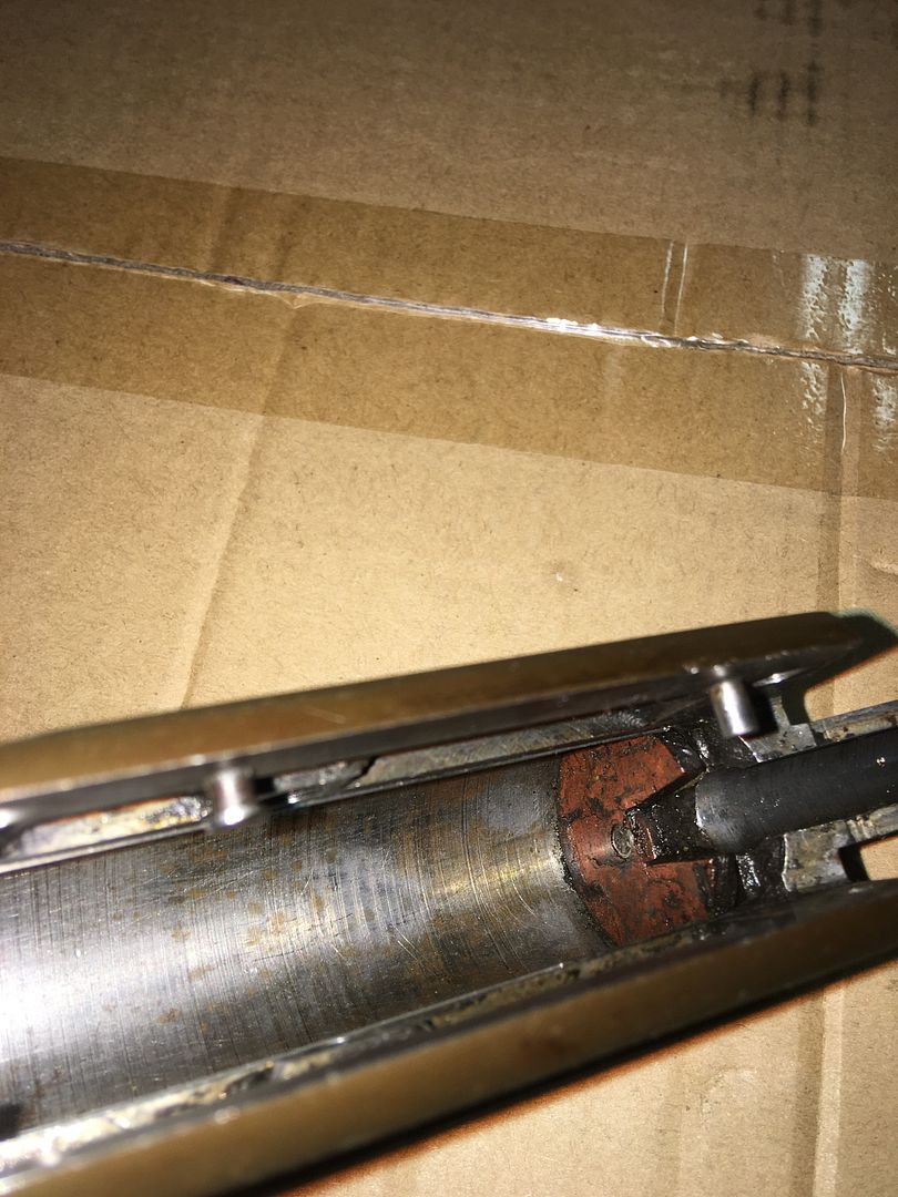

To my mind the biggest drawback to these guns is the buffer. It's there to save the rear of the receiver from getting battered by the bolt, and also to prevent the firing pin from contact and causing an inadvertent discharge if the gun is hand cycled while loaded. Lose the buffer, lose the protection.
I was actually surprised to find the buffer in there as I'd heard they were added years later. I took the gun apart to see if early guns had the same milling in that area the FN guns do. But whether or not the buffer is original, there is no milling.

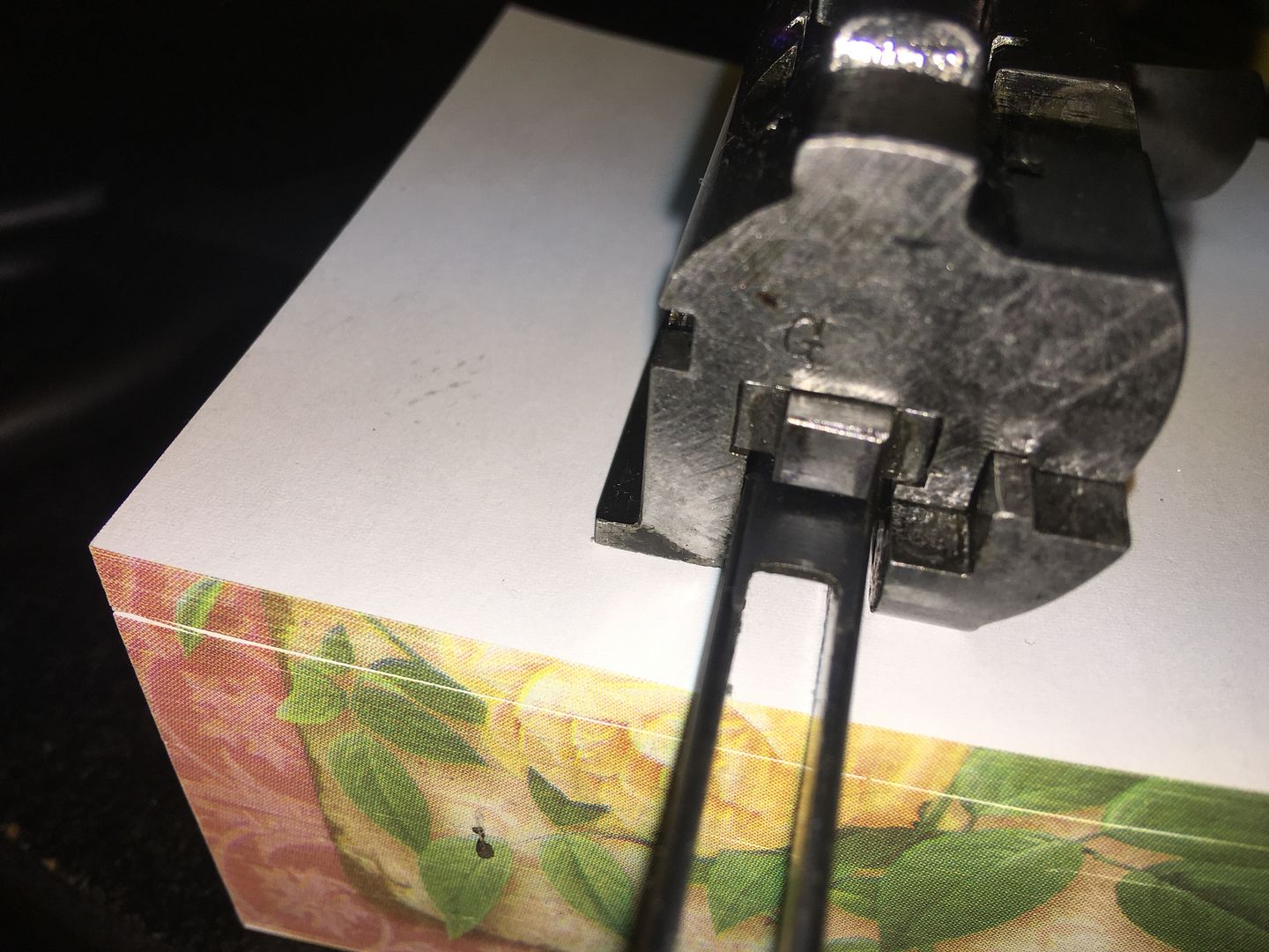

Here's the back of the bolt showing the firing pin.

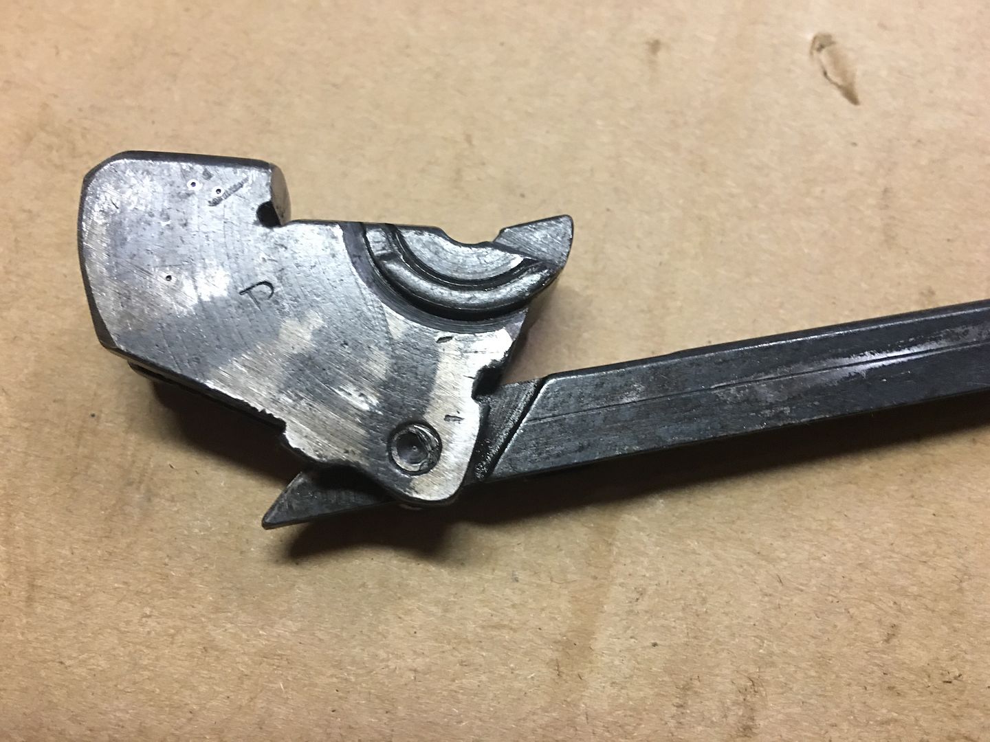

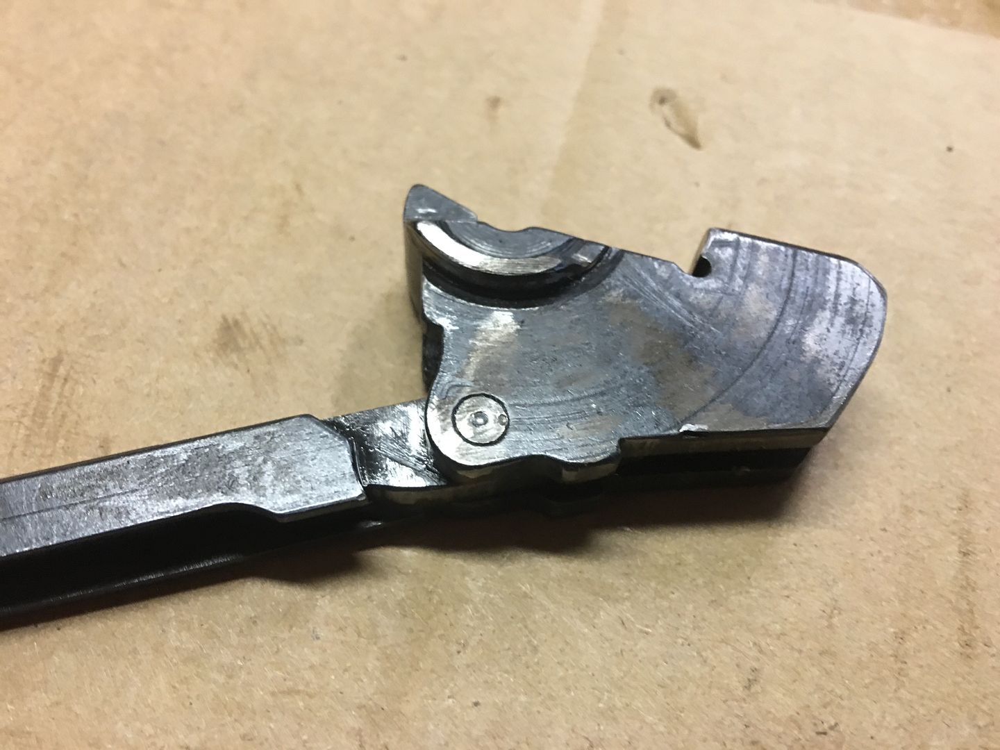

One of the weaknesses of FN's version of the gun is the rail on the locking block. Until 1958 it was thin and prone to breaking. The prototype and first year (1903) guns had rails on both sides, and so does the RAS.
Unequal in height, the rail on the left is 1mm high, and the right rail is 2mm. That pretty much matches what I found when I disassembled my 1903 Browning.

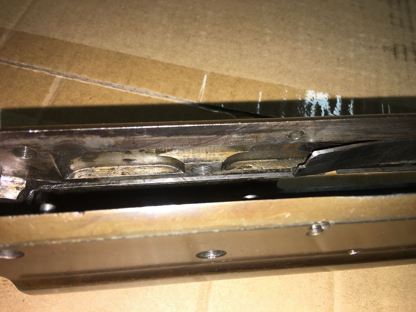

In 1936 FN/Browning removed metal from inside the receiver (and elsewhere) of the 16 gauge to lighten it, and the "Sweet Sixteen" was born. Ten years later they did the same thing to create the "Light Twelve". So today I was surprised to find lightening cuts very similar to those used on Brownings, only these were done almost 30 years earlier.

Rudolph send me an email at WilliamGurton(at)Hotmail(dot)com and I send you a photo of a first year receiver. I didn't take it all the way down since I didn't want to mark the carrier screws. Yo can see that it is recessed to accommodate the firing pin.
I checked a 130,xxx serial number gun and it had the red rubber buffer.
