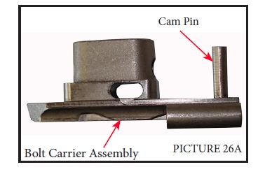

I went for my first duck hunt with the V3 and after about 15 rounds of Kent Bismuth 1350 1 1/2oz number 4s the gun just locked up. The bolt was closed and wouldn't move, there was a round sitting on the lifter. I felt like the round stuck in the chamber had been fired but no way to easily tell. I had a backup gun back at the truck so my hunt wasn't ruined but it sure didn't feel good.
When I got the gun home and took it apart the pin that sticks up from the bolt carrier and rotates the bolt had broken off inside the bolt. Once I dug it out I was able to rotate the bolt with a screwdriver and get the thankfully spent shell out. There had never been any signs of wear on that pin before. Has anyone else had anything like this happen?
What it should look like. Image
What it does look like. Image

Not made of plastic but it looks to be a cast part. I don’t know how much stress is supposed to be put on that post during normal use but it doesn’t look like it can handle much. Looking at it I have to assume it is designed so that it only rotates the bolt and is stopped before it slams into the front or the back of the bolt sleeve, it just doesn’t look strong enough to do that without snapping off at the base again. If it was a pin inserted through the base it would be stronger than just having a molded on post.
 Post subject: Re: Broke my V3 Field Synthetic
PostPosted: Sat Dec 23, 2017 5:53 am
Posts: 26799
It is the cam pin.

It is a steel pin press fit into the steel bolt carrier bottom plate. I am not a metallurgist, so I don't know the exact properties and composition of the metals involved, but to the layman it is steel and steel. NO plastic in that part of the gun.
