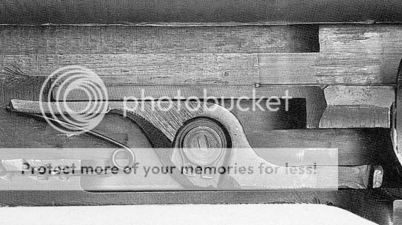

That is a classic sign that the intercepter latch isn't working. That is what releases the second shell out of the magazine.
Man, that is a good photo, where'd it come from ? Yours ?

oregunner wrote:
Google images
I managed to find a few like that but not the original source. If there is an on-line resource that uses those photos I'd like to find it.

Mine looks just like the picture posted. Nothing appears broken or bent. When I was manually cycling the action (unloading the gun) after a hunt this morning it cycled the first two rounds fine and the third stayed in the magazine. So I flipped the gun over and looked at the interceptor latch and is was stuck halfway. I bumped it with my finger and the shell popped out. I can push on the interceptor and it feels smooth. Plenty of resistance from the spring. I have no idea what’s going on with it. Maybe there’s a bunch of $hit built up behind it. I’ll take it off and clean/polish it.
