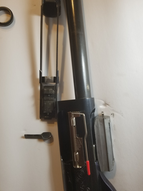

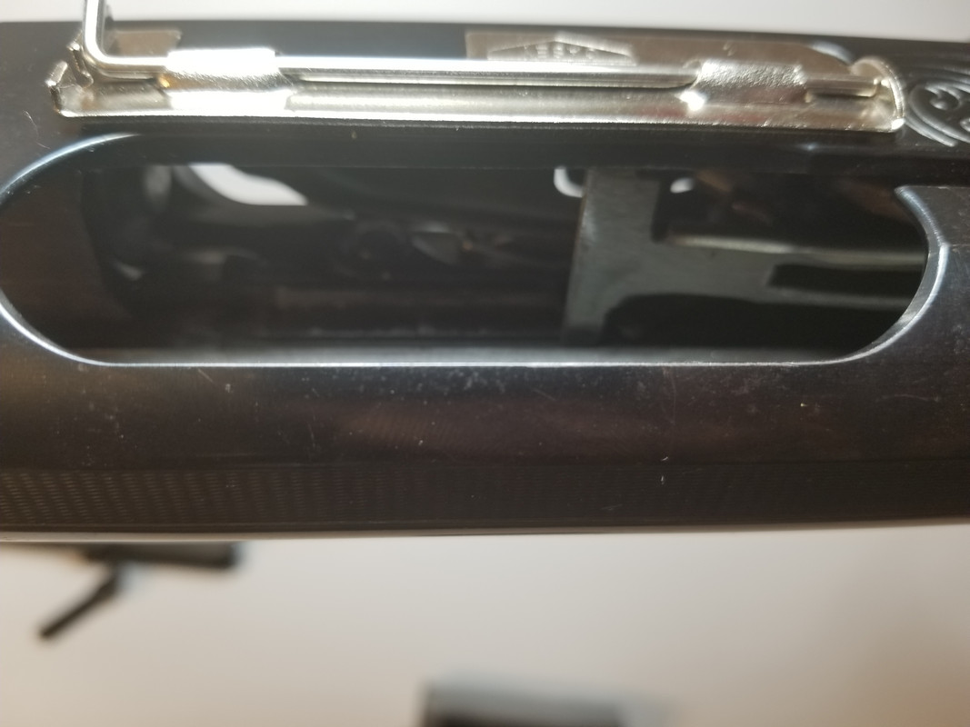

I just wanted to get an idea how worn out it is. My initial thoughts was it was used only for hunting and I wouldn't think it has more then a few thousand rounds in it. But I also have no idea what I am doing!

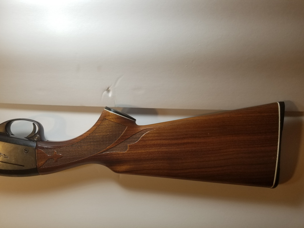

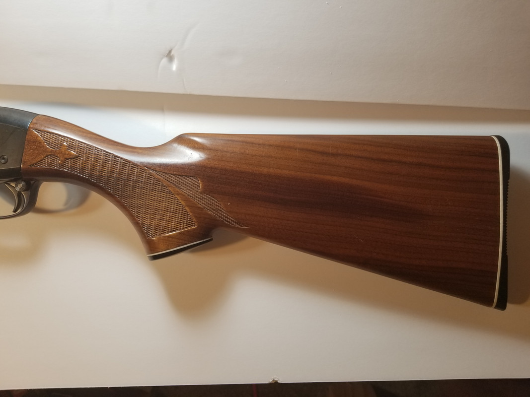

Also that is the lowest/cheapest grade wood right?
Anyways here are some pics. I can get more if needed. It is a 1972 built gun.
Just want to see if I am going to expect a lot of life out of it still or if it looks on its last legs.

Why would you think it is on its last legs?
Yes, that looks like standard grade wood.
From what is shown it does not look to be too worn to me. I would replace the O ring that is not shown, clean the split gas pistons and lightly lube the gun and you should be good to go. I would do the same to the trigger assembly. Make sure the gas ports are clean with a pipe cleaner. Assemble properly especially the link that fits into the cup of the stock action spring tube.
The only area you should also check before buying the gun is the barrel for any dents, bulges, etc. The barrel extension and the bolt locking recess will be where you will see the most wear. There are some real experts on the 1100 here so you may get some other, more thorough advice.
Randy Wakeman provided a very detailed instruction some time ago on the care and maintenance of the Model 1100 by some expert/s that would be good to have. Good luck!

Looks nice, was it someone’s trap gun ?

With almost all the bluing intact on the mag tube it hasn't been shot very much.

Thanks for the info all. I owned it for a few months and have shot it with out issue, the gas ring is brand new, why it was not in picture.
I just wanted to get an idea of the expected wear left in it since I will be using it as a trap gun and putting 10k+ rounds a year in it to start if not more. Sorry about not being clear in the first post.
Mcfarmer, it was a hunters gun I think. Had a slug barrel on it at first. I was concerned it might have some obvious signs of wear that I was missing.
Virginian, it shoots great so far! was just concerned about longevity since the gun is an older one and may have been abused! but everyone here has addressed my concerns!
Skeet_man, That is what I kinda thought but was not sure. Figured best to ask.
Oyeme, I am going to follow that complete guide. I want this gun to last me a while! It was not that I thought it was on its last legs, Just asking about the worst case to be prepared, but hoping for the best :) .

Looks to be in pretty dang good shape to me for a 1972 gun.
