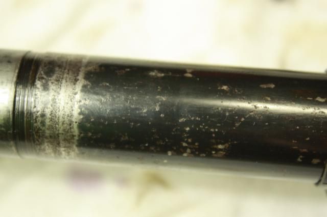

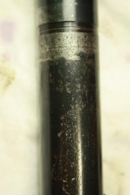

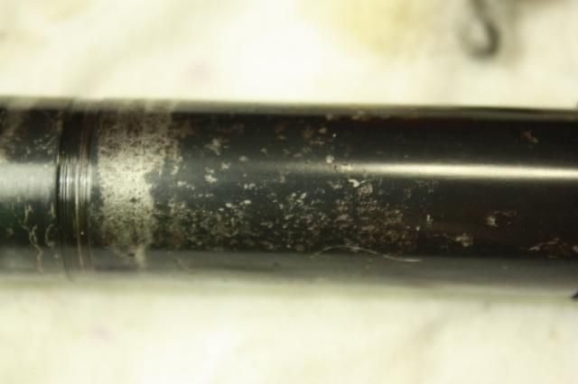

Just bought my first 1100. It came from a pawn shop, apparently the previous owner believed in wiping the outside down, but never cleaned the insides. The exterior of the magazine tube has some heavy pitting on exterior near where the piston works etc. Is this something that I should be worried about?
 Post subject: Re: How to clean the Rem 1100 - Complete Description With Ph
PostPosted: Sun Apr 13, 2014 6:55 pm
Joined: Tue Aug 10, 2010 8:21 pm
Posts: 7179
Location: Oregon
I hope you didn't pay much for it, without looking it over. The magazine tube is not a DIY replacement project. I would clean it well, go over it with steel wool, lube it, and hope for the best. If the rings slide back and forth relatively freely over the pitting, it will probably function. I would carefully check over and clean the gas cylinder and ports as well. Mark

I paid 250 out the door for it, it has a 30" VR Full Choke Barrel, Here are the pics of the pitting I was talking about.
This is about the only negative on the gun.

I inherited an 1973 1100 from my father-in-law that has pitting just like that. I've had no issues firing light to heavy loads with it so far. Hope the same goes for you!

My Dad bought an 1100 with rust pitting just like that at a gun show over 30 years ago. I used a little fine steel wool & Hoppes #9 to remove the rust and smooth it down a little. That was my primary gun for over 20 years, and I'm guessing I put 30k rounds through it in that time. I still break out ol' Rusty when I'm in a shooting slump. My guess is your gun should function fine. Good luck!

For 1100 magazine tubes showing corrosion the tube can be coated with "Utra bore coat" ($50.00) used in rifle barrels to fill the corrosion pores. Once the coating has been applied place the shotgun's action in your kitchen oven to bake the coating into the metal. The final coating finish will be very smooth and so much easier to clean the magazine tube after use.
