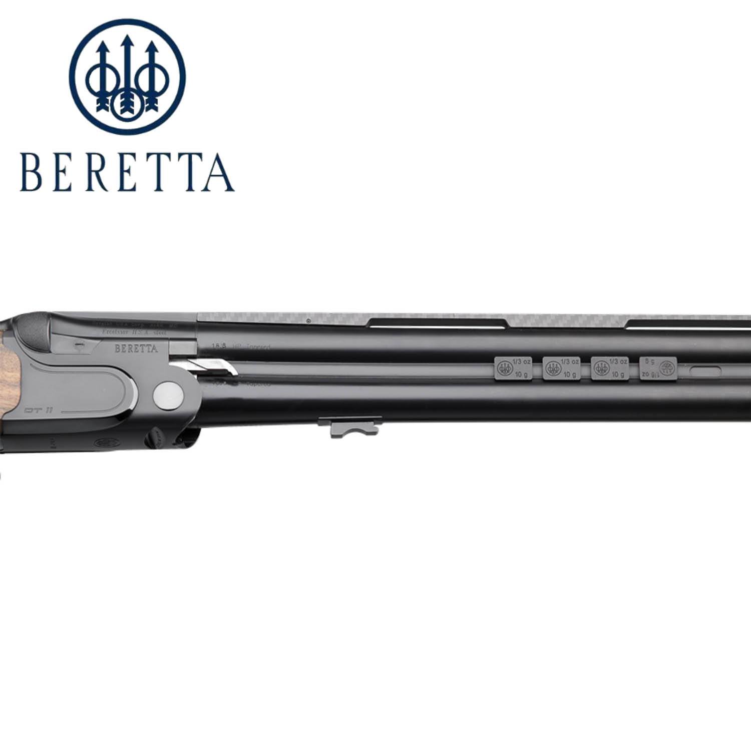

I had Tronspace make / install a adjustable comb and butt plate on my Beretta 694 .
( yes he did a good job {hs# )
It’s now a tad stock heavy . Do I put in a lighter weight in stock or Beretta magnetic weights in barrel forearm . I would think forearm but $155 the stock weight kit is only $40
It won’t take much to balance.
Beretta 694 32"

Barrel heavy = slow swing
Barrel light = faster swing but I whippy
I like neutral swing
More weight = Les recoil
magnetic weights Are easy to
Add or subtract
But yes $$$
https://m.youtube.com/watch?v=Ht_Dp2DjeYU
See Video above . They balance from factory
Beretta 694 32"

 Post subject: Re: Beretta 694 balance how stock or barrel weights
PostPosted: Thu Feb 11, 2021 7:06 pm
Joined: Mon Mar 07, 2005 7:12 pm
Posts: 1324
Location: South east Michigan
Ordered . Clean easy to move or take off . ( magnetic)
Somebody needs to copy and sell for half price .
Beretta 694 32"

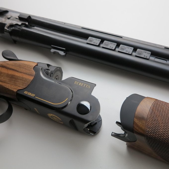

Most people that want barrel weights under the forend want the most weight they can get.
With the Beretta weights you get 3.17466oz for $150+, with my weights you get 3.5-4.5oz (depending on length) for $65...
I've heard this logic but, I mean, Beretta went to all the trouble of making beautiful, lightweight barrels with factory thinwall, superlight chokes, etc. They even have "carbon fiber" ribs for even more weight savings.
Then we go and hang lead on them. Why not just buy a Browning or Krieghoff with bulged factory chokes and way thicker barrel walls if we want a heavyweight barrel set?
In my opinion, Beretta made their barrels too light for most people. A majority of the weights I make are for Optima and later Beretta barrels.
I was hinting you should make them .
Incredibly high startup cost and incredibly small market.
Also, are you sure these fit the 694? Beretta only lists them for the DT11 and 692 (and possibly even more specifically only the "Black" carbon fiber models), and the mid ribs are specifically designed to accommodate them, notice the oval inlet in the mid rib. I don't think these are going to fit your gun unless you have those inlets.
Then again, looking at the way Beretta made the mid-rib on the b-fast guns, you're probably better of going with their system instead of mine anyways.
