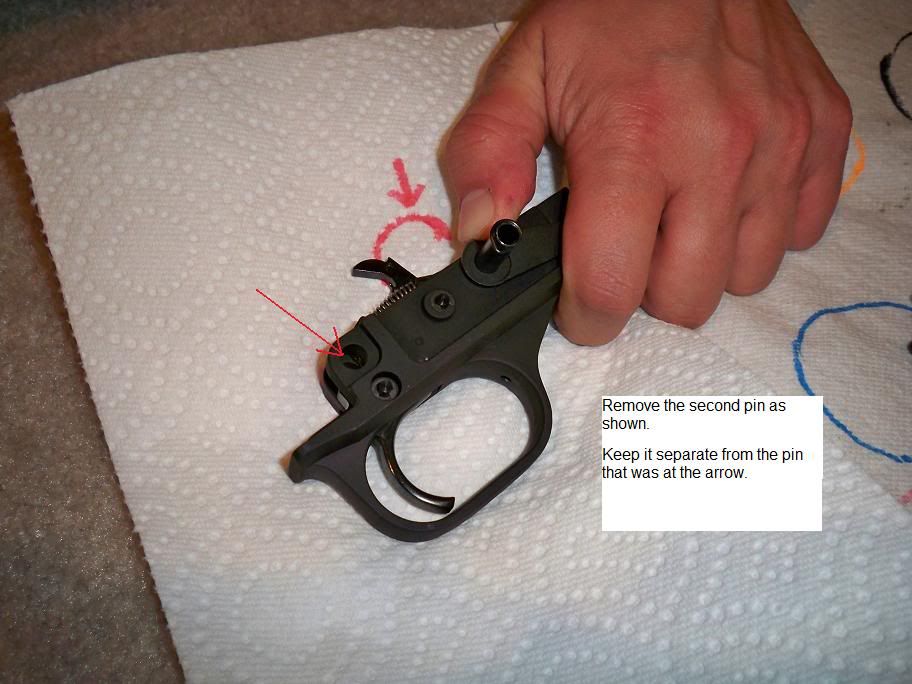

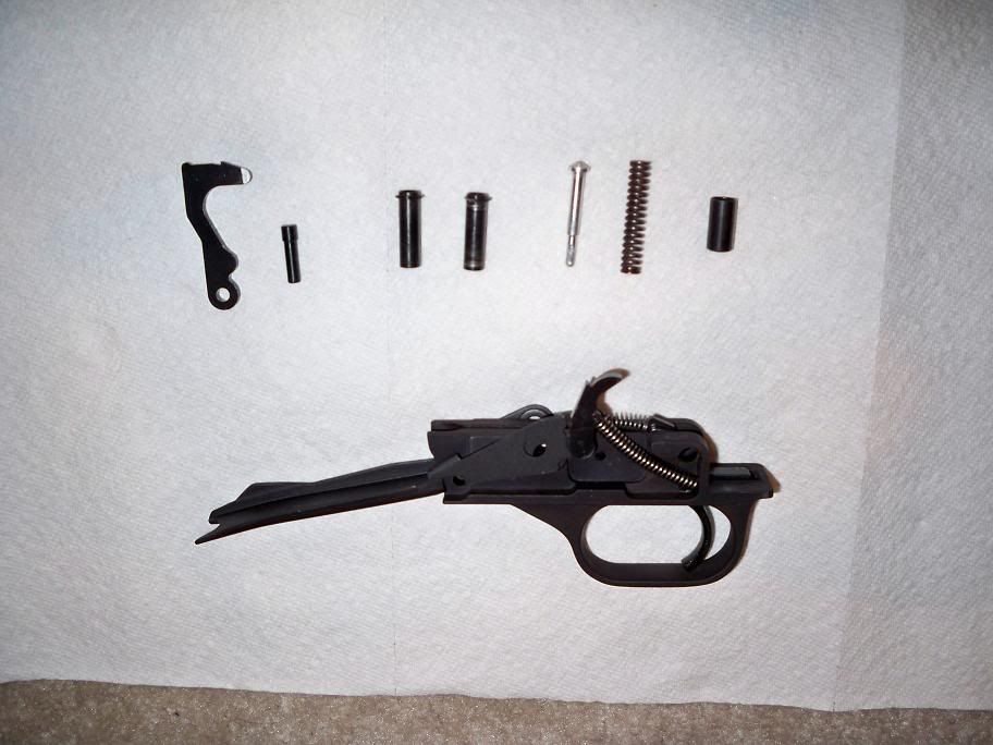

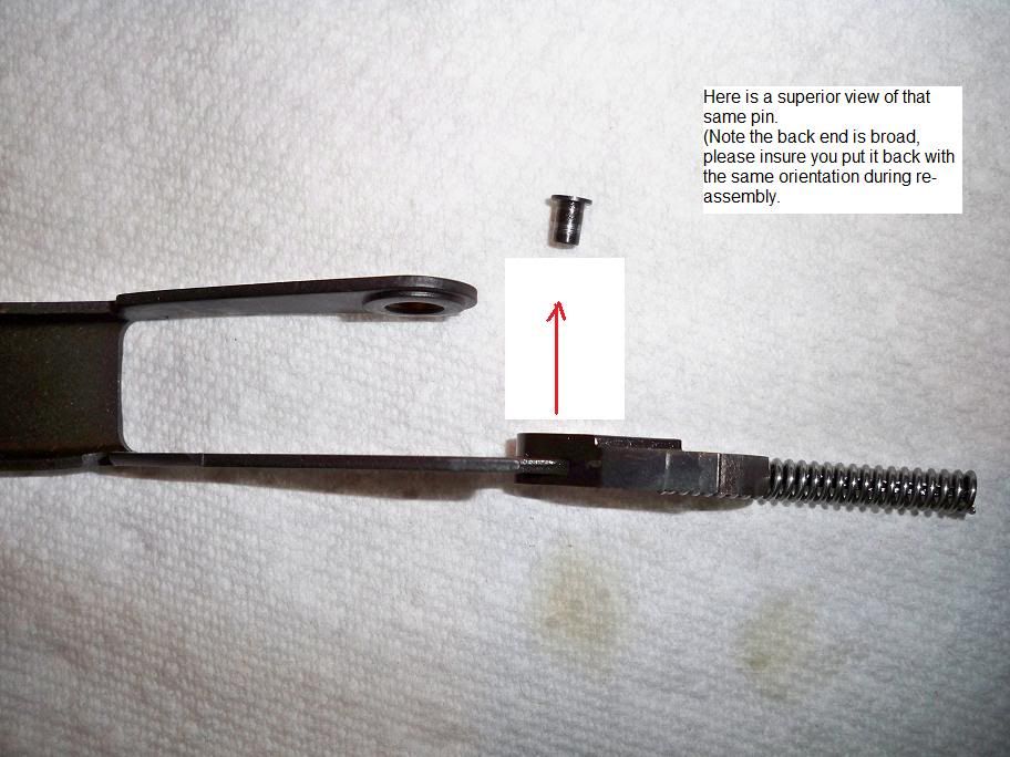

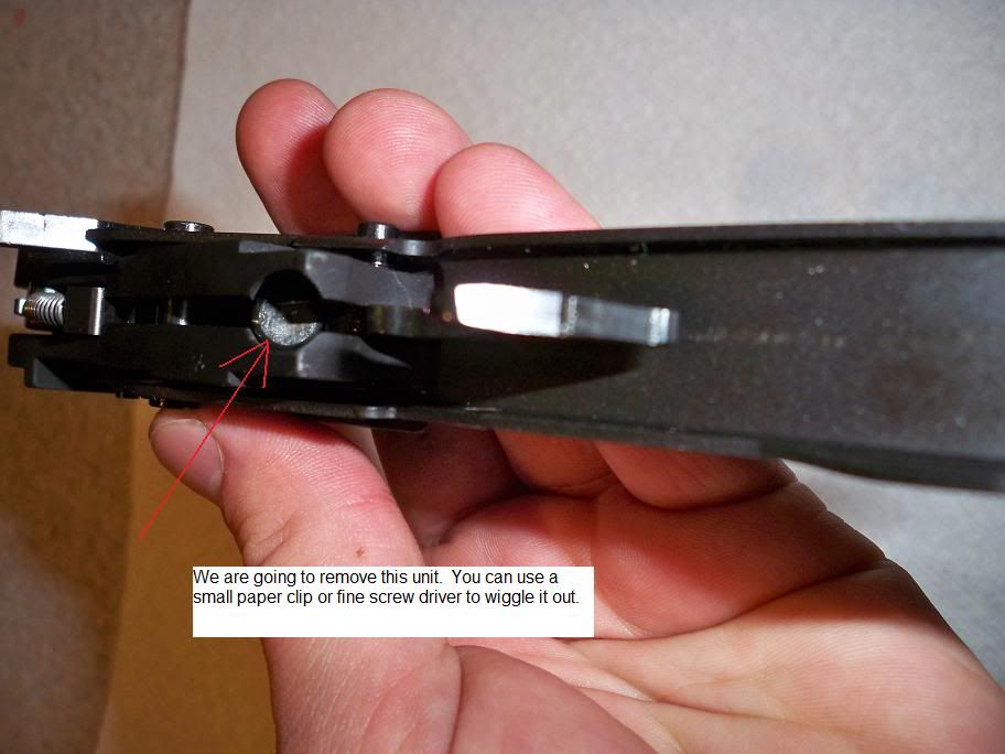

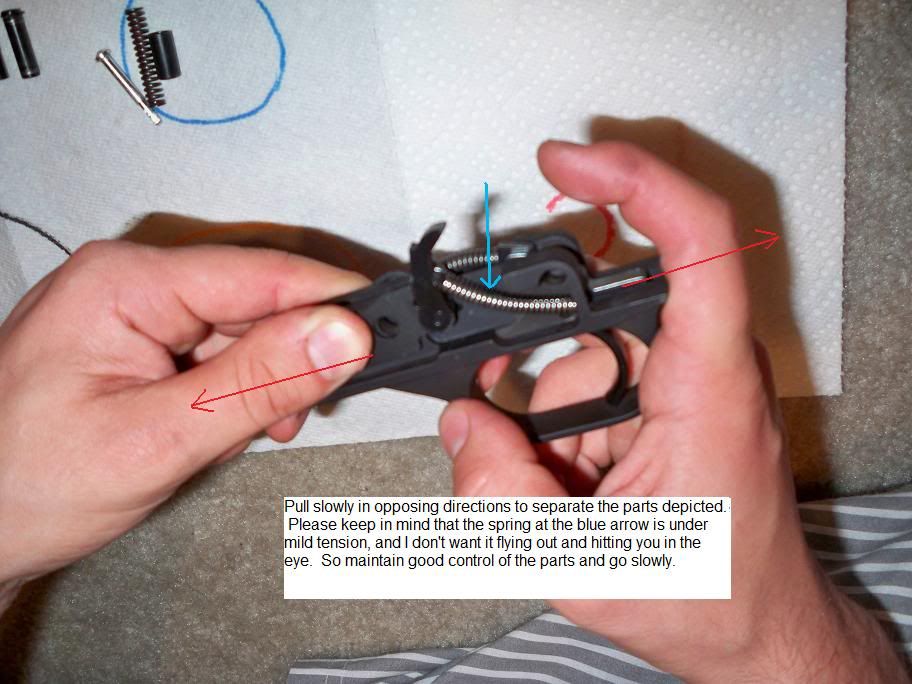

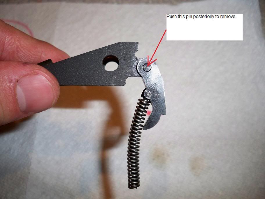

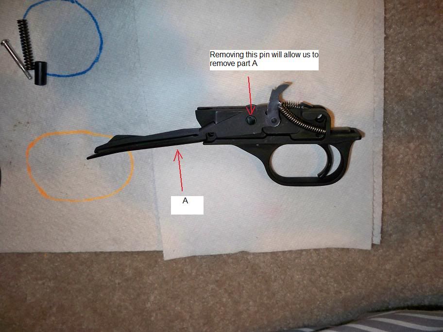

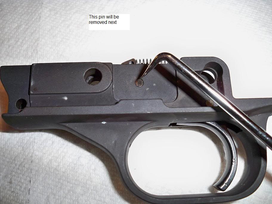

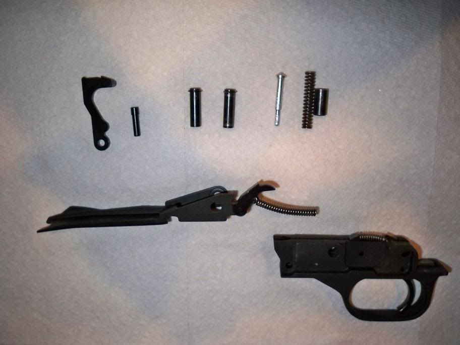

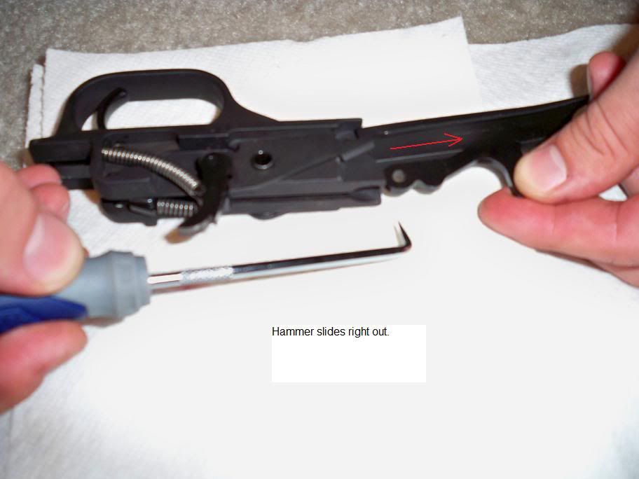

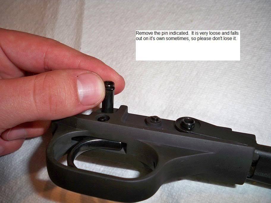

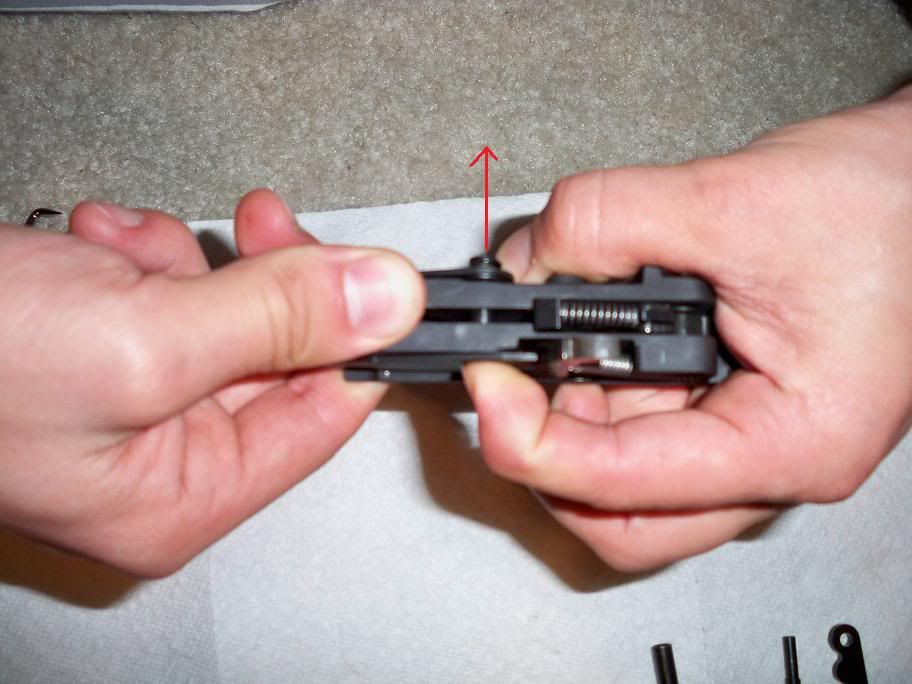

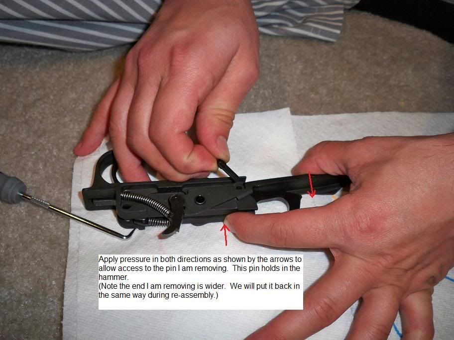

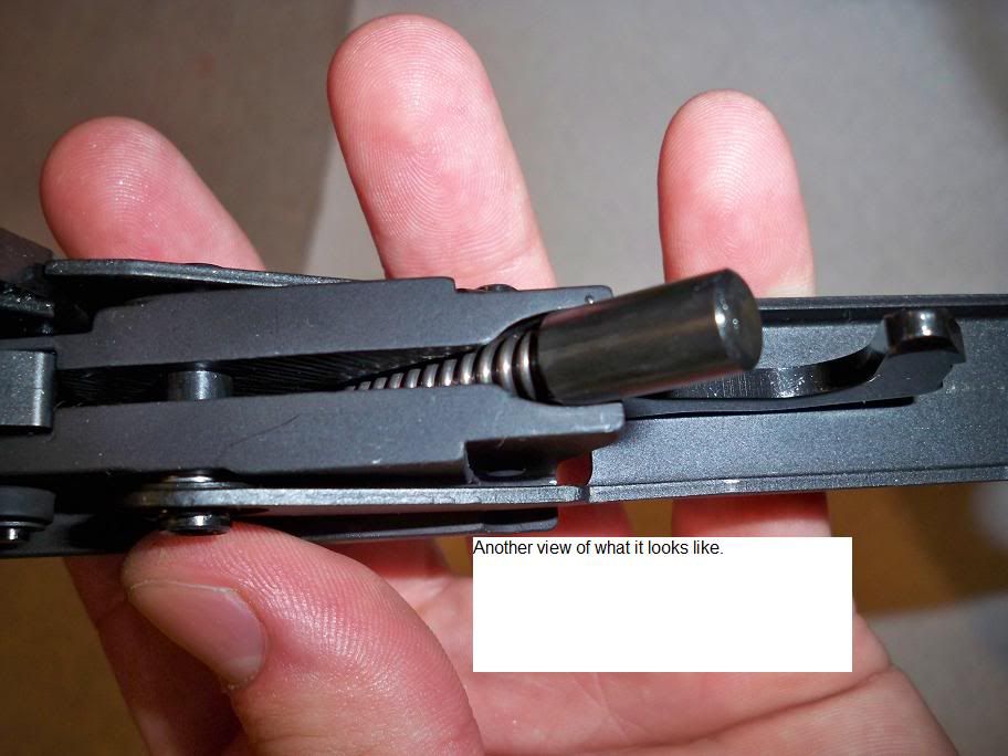

Hi folks, this tutorial took me a few hours to complete; however, if it helps someone out who is interested in knowing how to do this I have accomplished my goal. I have learned a lot on this forum, and there is a great wealth of information to be learned. I hope, in some small aspect, I can contribute to making this forum even better. I hope you guys enjoy it!
**Please be careful when taking things apart in the trigger assembly! Some of the parts have springs and are under tension; I have included notes on when to hold certain parts of the trigger assembly firmly to insure parts don't fly off. Mossberg advises AGAINST taking apart the trigger assembly, and although, I think, it is easy to do safely with some common sense and control, please proceed at your own risk! I will not be held liable for any injury you do to yourself or others while following these directions; furthermore, I am not liable for any damage you do to your firearm.**

That's all there's to it :D !
If you guys have any questions, please let me know.

Thanks for posting this! While monkeying with my new 930, the cap on the spring shown in picture 5 came off. Without this I wouldn't have know where it came from.

Sorry it took so long to respond. I think i am missing the little black piece that goes over the pin and the spring. Can you tell me the name of that piece and where i could maybe order another one. If that even has anything to do with my gun jamming up? But i did realize that piece is gone.
