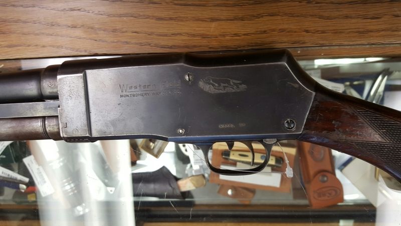

I have a Stevens Model 520, although mine is a Montgomery Ward's Western Field Model 35. I love mine, love shooting it, but at this moment the action arm is at the Gunsmith being welded as it developed a stress crack sometime over the last eight decades... Can't wait to get it back!!!
Anyway, I was amazed to find that mine was a lot "newer" than I thought. I had thought mine to be of late 1920's or early 1930's vintage, looks like mine is late 1930's vintage, not that it really matters in the grand scheme. Mine has the "cross bolt" safety.
