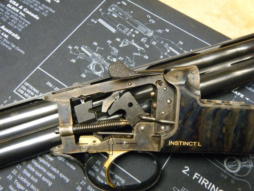

Any issues with recoil from the 1st shot, with the safety going into the safe position? Today I fired up my new 12ga L and shooting #4's, 2 3/4 length with velocity of 1330 from time to time the recoil of the 1st round would put the darn safety on.
Anyone know how to remove the auto safety feature of the Instinct?
Also had an 'one' issue with the firing pin stuck (at least I believe) in the primer. Ran a rod down the barrel and lightly hit the hull a few times and presto, I was able to open the firearm.
This can be done very easly by removeing the rear stock .when you get the stock off you will see a L shaped rod hooked to the bottom of the safety lever .gently lift the the short L shaped end out of the safety lever with a flat blade screw driver and roll it over so it is pointing up you then can pull it out of the receiver.i did mine 5 mins after I got the gun home .
Thank you, will do it this weekend.
Note following picture that I have the arrow pointing to, is that the safety lever? If so, how did you remove without bending the lever. When I attempt to 'gently lift' it feels like the arm will bend.
[url]Image[/url]

Put the barrels back on the receiver. Open the action to cock the hammers. Push safety forward and then pull the trigger. Then open the action slowly and watch the rod that pushes the safety button rearward. It may do it on the opening or the closing of the action. That will be the rod that you need to deal with.
It might be clearer in the picture if you had a plain background instead of the barrels lying behind the trigger mechanism.

oldMan1943 wrote:
[url]Image[/url]
Yes that is the rod you want to remove .you first need to remove the hammer strut and spring on that side .you will need to grab the strut right where it sits into the hammer with a good pair of need nose pliers.pull back on the strut until it clears the hammer then toward you .the hammer needs to be uncocked. once you have the strut out you need to put the safety in the on position to allow the rod enough travel for the short end to come out of the safety lever.once you have the short end clear roll the rod so that the short end is pointing up .you then can gently lift it clear of the receiver as you put it rearward. i had no problems removeing it and it is still as straight as when it was installed.hope this is of some help.TB :) ps see next post below for more info.
