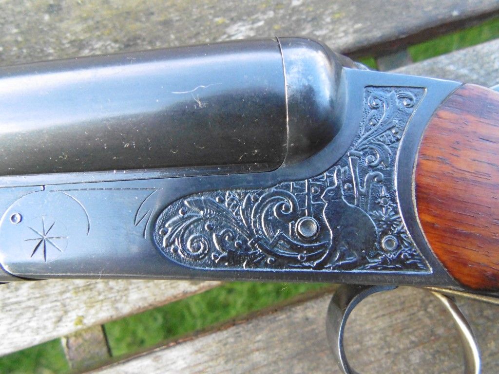

Overall in nice condition and just back in from a round of sporting. The central ejector spring either pings the left, right or both ejectors depending on the combination of barrel fired and the action of the trip/ release sears in the fore end. Shown with the tip of the screwdriver is the central selector 'switch' for changing between selective eject or extract, shown horizontal for extract.

Gone mad with photo bucket now, a couple more pics!

Wow superb
I wish I could get 1 the super clean piece.

Now that's interesting. I mean, export grade guns didn't usually have this level of engraving. Do you have a clue as to the history of the gun (who and how first bought it, etc.)?

There were many grades available on local market. Some of them were lower than what was sent for export, others - higher, with more engraving, etc.

This one caught my eye as there is a good trace of figure to the woodwork and as mentioned some interesting 'engraving' ( very industrial, looks as though it has been milled in!) which adds to it's charm.

Got one today, Bluing 100% not a scratch on metal anywhere only mine has a thick baikal rubber pad, same scenes on sides, not a pit,scratch or scrape. I like it alottt.
