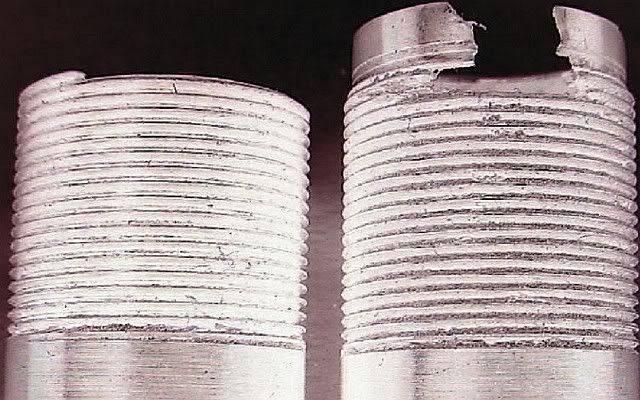

If the overall quality of a barrel is less than perfect, there can be effects from parts not directly related to the forcing cone, such as a rough bore or crooked choke hole. Those may create difficulties that affect barrel test results, but doesn't mean that a proper barrel can't show improvement.
I have been pointing out the fact that crooked choke tube holes are a fact of life, and many of those posting after my comments and pictures are unable or unwilling to admit what can be seen in photographic evidence and recommend a crooked shooting barrel be corrected by getting shims to adjust the stock to alter the point of impact.
Shims are fine to allow a gun to be more aligned to a shooter's body and face, but to have the shooter's face over to one side to correct for a crooked choke is barely a "band-aid" approach that does nothing to correct pattern degradement from that crooked choke.
Is this a figment of my imagination, or does a crooked choke hole sometimes have undesirable consequences?
Does this obviously offset forcing cone have no effect on the shot? If it does, then how can altering a forcing cone NOT have some possible effect?
