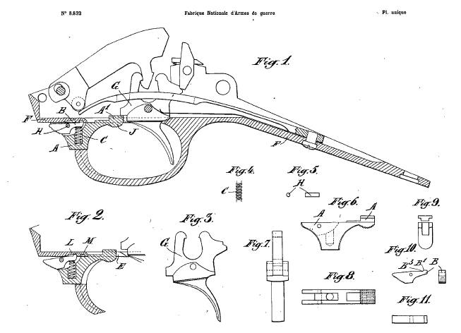

FN filed a patent for the type 2 Safety type 2 in Belgian patent office on January 23, 1904

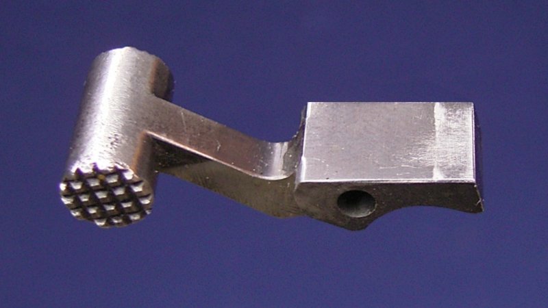

Misc. In 1909, the type 3 safety was introduced. Another FN invention, patented at least in France. Said patent was filed in French Patent Office on April 28, 1908
