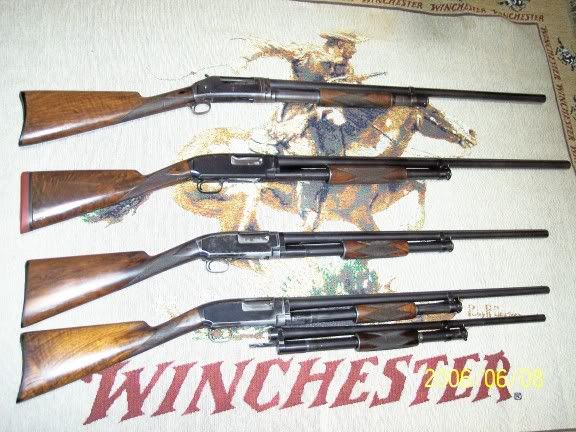

Yes. Plain round 26-inch SKEET barrel. Actually, when the gun jumped out of a pawn shop in Denver in 1970 and begged me to take it home it had two barrel and magazine assemblies, the 26-inch SKEET and a 26-inch with a Cutts Compensator -- $110. During the time I was stationed in San Diego, my gunsmith Dan Dwyer on West Washington Street, had a NOS 28-inch Modified plain round barrel, so I had him fit it to the magazine assembly that had the Cutts barrel and I then sold the Cutts barrel to a skeet shooter in Iowa.
My Model 42 now --
